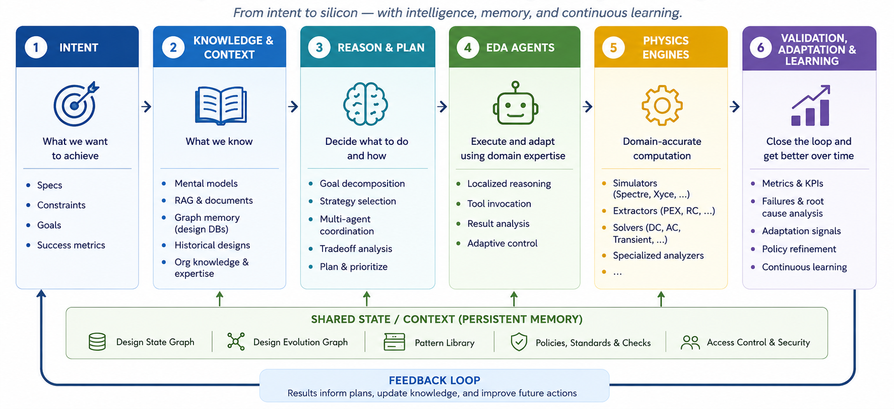

And where do we go from here?
The most compelling future direction, in my view, is not a larger language model. It is a persistent analog design intelligence system built around four foundational ideas.
1. Graph-Native Design State
Represent devices, nets, hierarchy, constraints, layout regions, simulation results, verification artifacts, metrics, agent actions, and failures as a heterogeneous temporal property graph.
The graph should support reasoning about any historical design state, not just the current one.
2. Separation of State and Evolution
The current design and the history that produced it should coexist but remain logically distinct.
The State Plane answers: “What is the design now?”, while the Evolution Plane answers: “How did it get here?”.
This distinction enables replay, rollback, learning, auditing, and pattern mining.
3. Learning from Design Trajectories
Every iteration should generate something akin to a reusable record, say (state, action, next_state, metric_delta, provenance)
Over time, these trajectories become a source of transferable engineering knowledge spanning designs, teams, and topology families.
4. A Composed Reasoning Kernel
Symbolic systems should own hard constraints. Graph reasoning systems should own structural inference and topology retrieval. Language models should own planning, explanation, and interaction.
Essentially, the LLM should be a component of the system, not the trust boundary.
Together, these ideas point toward AI systems that do more than automate engineering workflows — they accumulate engineering judgment.
ChandraM LongPost AgenticStack
Analog Design Intelligence Architecture
