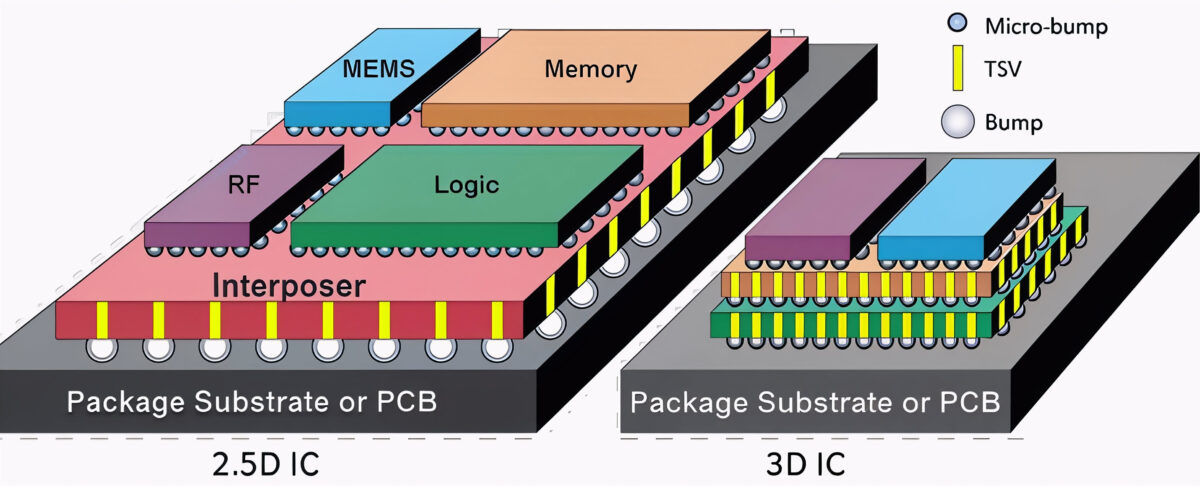

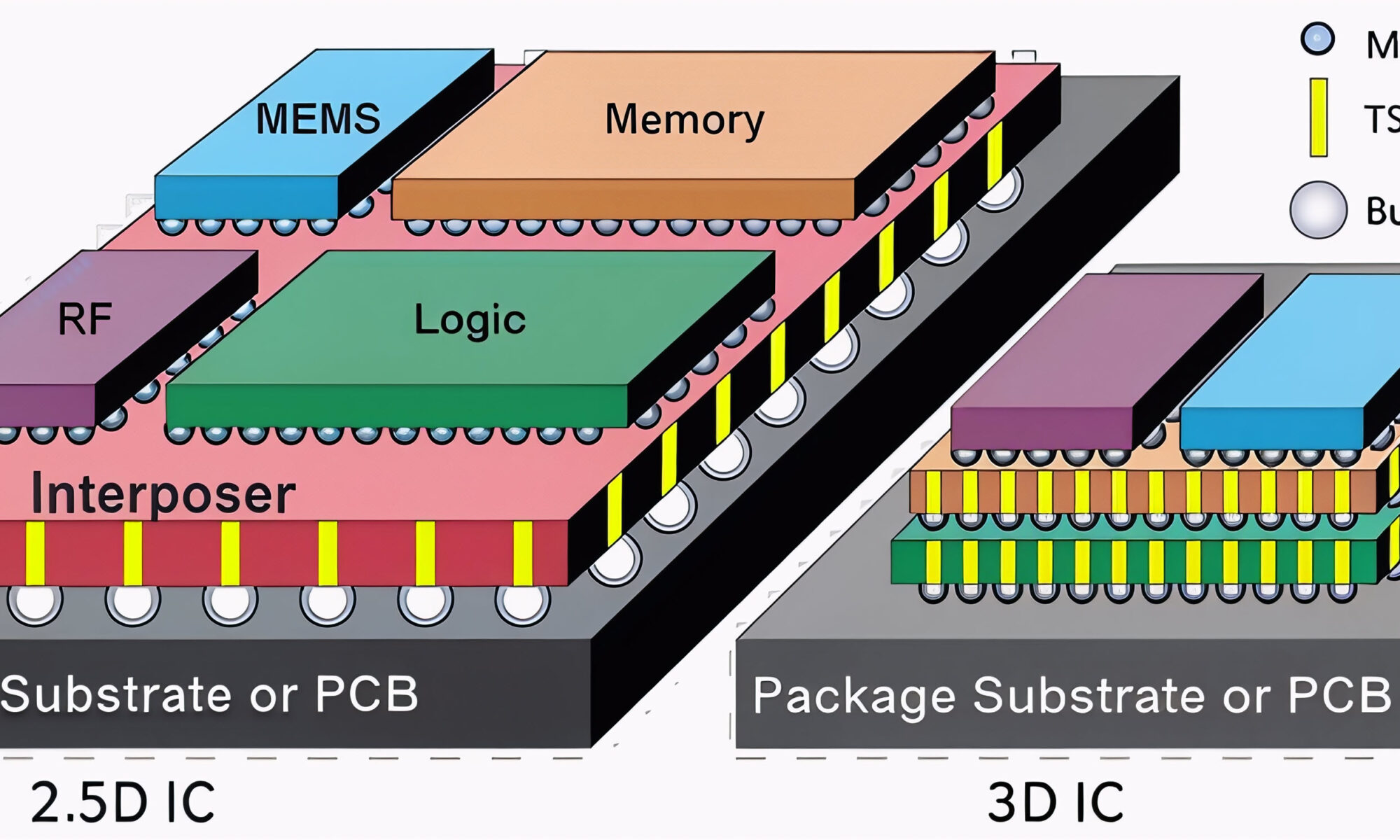

3D integration is revolutionizing IC design. In 2.5D architectures, dies sit side-by-side atop a silicon interposer. Micro-bumps (or Hybrid-bumps) connect each die to the interposer, and flip-chip bumps connect the interposer to the ball grid array (BGA) substrate. Full 3D integration stacks dies on top of each other, linked by through-silicon vias (TSVs). Designers often mix technologies and process nodes across dies, leveraging different vendor solutions for interposers, packaging and fabrication. Each integration method introduces unique benefits along with specific ESD challenges. Figure 1 demonstrates the main difference between 2.5D integration and 3D integration.
fig1 3d structures
Figure 1: 2.5D versus 3D designs.

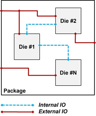

Traditional 2D ESD verification considers all chip pads as interfaces to the outside world, and these demand robust protection against ESD events. In 3D designs, however, many pads serve only as internal die-to-die connections, not external IO interfaces (figure 2). This distinction is crucial:
  • External IOs face ESD events from package pins and require comprehensive protection.
  • Internal IOs are far less exposed and can use smaller, more efficient ESD devices—saving area and cost.
fig2 external vs internal ios
Figure 2: External IOs versus internal IOs.
External IOs are connected to the package pins and face more ESD events than internal IOs. Similar to 2D designs, external IOs are affected by both human body model (HBM) and charged device model (CDM) ESD events. However, internal IOs are affected by far fewer HBM and CDM events. This difference means internal IOs can use smaller ESD protection circuits, which in turn translates into significant savings in die area and cost without sacrificing overall ESD protection robustness.

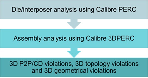

Modern ESD verification tools, such as Calibre 3DPERC, address these new challenges head-on The recommended workflow combines die-level and assembly-level analysis. Using Calibre PERC, designers first verify the ESD robustness of each die and interposer. Calibre 3DPERC then performs system-level checks, identifying point-to-point (P2P), topology and geometrical violations across the assembled stack. This robust approach ensures that ESD reliability is maintained throughout heterogeneous 3D architectures (figure 3).
fig3 ESD verif flow
Figure 3: 3D ESD verification methodology (using Calibre 3DPERC).
