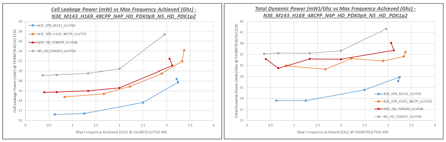

The hybrid libraries in N3 make things really interesting, from the benchmarks we've seen they decrease power and area but don't increase speed for obvious reasons (H169 is 2 fin, M143 is mixed 1-fin/2-fin).
While the freq bump looks about right, I must say I am surprised how little the dynamic and leakage power improved for the 2-2 config over it's N4P competition doubly so since this is N3E not N3B. The 2-1 power results at least look pretty good while also providing a small freq bump over N4P 2 fin.

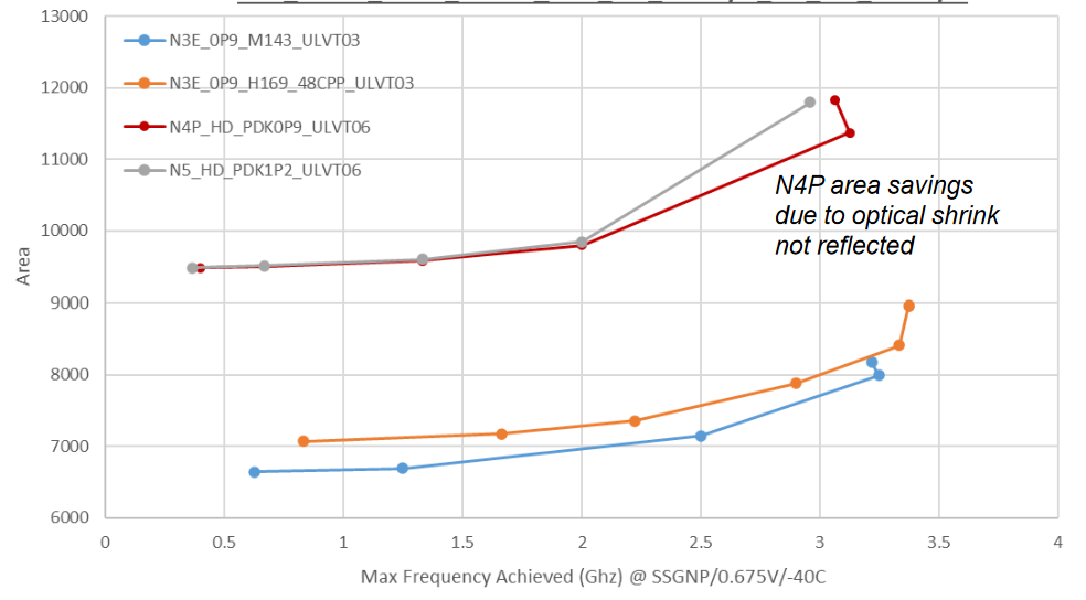

The power comparisons I gave were for a complete CPU core, not low-level gates. Here's the area benchmark for the same case:

I think this is showing how little the improvement from raw process is nowadays, which is not that surprising when you look at how small the layout differences/pitches are between N5/N4 and N3. There's quite a big density (area) improvement (not so much from just pitches, also from DTCO) and the hybrid library only gives a little extra, but power is the other way round, most of the improvement comes from the hybrid library and other DTCO improvements.
Which means if you compare "N5/N4" with "N3" power and area are both considerably improved, but the power saving mostly comes from DTCO i.e. the hybrid library. Which is only available in N3 and there's no reason not to use it, but you could say is not being entirely transparent about where the PPA improvement is coming from -- though the other point of view (TSMC's) is presumably that "process technology" nowadays means [raw process + DTCO libraries] and N3 is delivering as promised... ;-)

Are the 'C' metrics referring to degrees Celsius? Curious why it would mix 125C Y axis with -40C X axis?
Because they're the worst cases for speed (X) and power (Y) -- X axis is slowest (slow transistors, low voltage and temperature), Y axis is highest power (fast transistors, high voltage and temperature).
