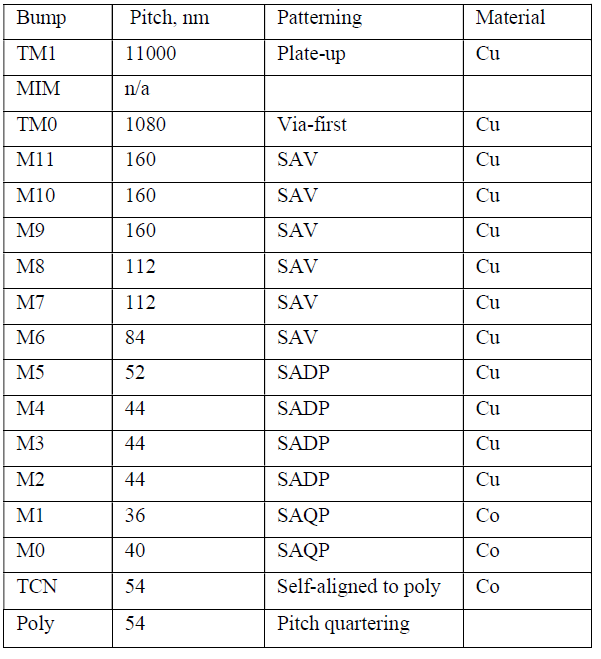

It's 10nm+ compared to the first version. The comparison was only the layer list and the MIM difference was mentioned. They did not show reliability comparison actually but presented the slew of reliability tests.

So according to Intel, removing COAG and/or cobalt interconnect is "no change" because the number of layers are the same?
How can you tell when an Intel PR guy is lying? His lips are moving....

From the abstract:
We provide a comprehensive overview of the reliability characteristics of Intel’s 10+ logic technology. This is a 10 nm technology featuring the third generation of Intel’s FinFETs, seventh generation of strained silicon, fifth generation of high-k metal gate, multi-Vt options, contact over active gate, single-gate isolation, 14 metal layers, low-k inter-layer dielectric, multi-plate metal-insulator-metal capacitors, two thick-metal routing layers for low-resistance power routing, and lead-free packaging. The technology meets all relevant reliability metrics for certification.
From the introduction:
Intel’s 10+ process is an update to the previously described 10 nm process, featuring improved transistor performance, 14 metal layers (vs. 13 metal layers), and a higher-density multi-plate MIM capacitor.

OK, so COAG and cobalt are back -- if they ever went away...
The problem Intel have is they've spouted so much BS since 14nm about how wonderful their 10nm process is and how soon it will be ready -- or that it's in mass production when it patently isn't -- that nobody believes them any more even if they are telling the truth, and they've done the same with fiddled/biased CPU benchmarks. It's the boy who cried wolf...
