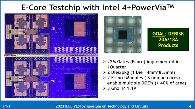

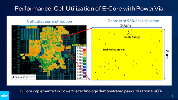

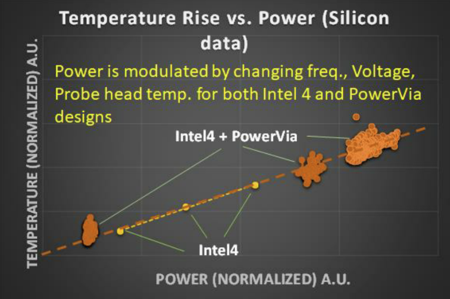

It would seem intel's design enablement team is unsurprisingly ahead of TSMC's when it comes to supporting BSPD chip designs, because intel said they were able to find some tricks to have matched thermals between intel 4 and intel 4 + powerVIA. Although this might just be an artifact of N2 having a higher thermal density than intel 4 making the thermals harder for TSMC to manage than it is for intel's 5"nm" class node.

The real test for Intel BSPD is foundry customer adoption. Using it internally is one thing, mass producing for outside customers is quite another. Same with HNA-EUV. Either way, Intel is pushing TSMC and Samsung which is for the greater good, absolutely.
Losing the power rails (and not having a keep out zone for the TSV/BPR) should offer a big density improvement. Of course that only matters if the FEOL is small enough for this to matter, and with GAA having lower footprint at iso drive a well designed standard cell should see a significant area reduction. If not perahps we see A14 adopt a narrower 4 sheet device for better short channel effects/to catch up the FEOL scaling to the BEOL scaling? Of course the benefits of BSPD can be blunted. Using N3 as an example due to their gate endcaps (especially on SRAM bitcells where there are also just less power rails to remove). N3's 2-1 mixed height library would presumably also see reduced benefit than the 2-2 or 2-3 as the 1 fin transistor appears to share power delivery with the 2 fin device. Since TSMC said N2 would have mixed row I would assume the latter issue will blunt some of the area benefits for A16, and of course it remains to be seen if they will keep their current endcap architecture or move to something else with N2 or N3E.

I believe the figures I saw for area/speed/power changes vs. power grid density (which I can't disclose) came from actual TSMC like-for-like layouts (same basic libraries) not theoretical calculations, so I'm inclined to believe them.

I'm sure Intel's figures for thermals are correct *for the particular case they chose to analyse*; whether this is realistic in real layouts is another matter entirely, they've been "economical with the truth" often enough in the past. Physics says the thermal resistance with BSP will be higher than with FSP, assuming the heat path is out through the non-bump side of the die which is the usual case -- maybe they chose a case where significant heat goes out through the bumps? (which is not normally the case).
I don't doubt the numbers (whatever they are) I just don't know how the results are what they are since I am running on an incomplete set of data and what seem to me as reasonable deductions based on publicly available data. Now maybe cell level density really correspond to chip area reductions anymore, but I don't have the knowledge to say if this is true or not. If this is the case I assume that would be due to routing conflicts? If routing conflicts are masking cell level density improvements then how is it possible for only certain kinds of HP chip designs to be restricted by routing? Either way; something is going on that is reducing the chip level density of A16 relative to what you would expect from depopulating the power rails from all std cells, a it isn't theory that you can depopulate the 2 power rails with backside contact. That is a fact that is as true as finFETs having superior channel control to planar devices.
They did an E-core cluster chiplet with on-die thermal test structures.
That reminds me! I think I saw Tanj talking about the idea of using the bumps/thick metals to carry heat out of the die and maybe one die doing some cool in die liquid cooling or heat pipes with them. I don't know very much about flipchip packaging, would there be big issues trying to run heat out of the bumps? As for things that are "normally the case", normally the metals are only above the transistor ;).
