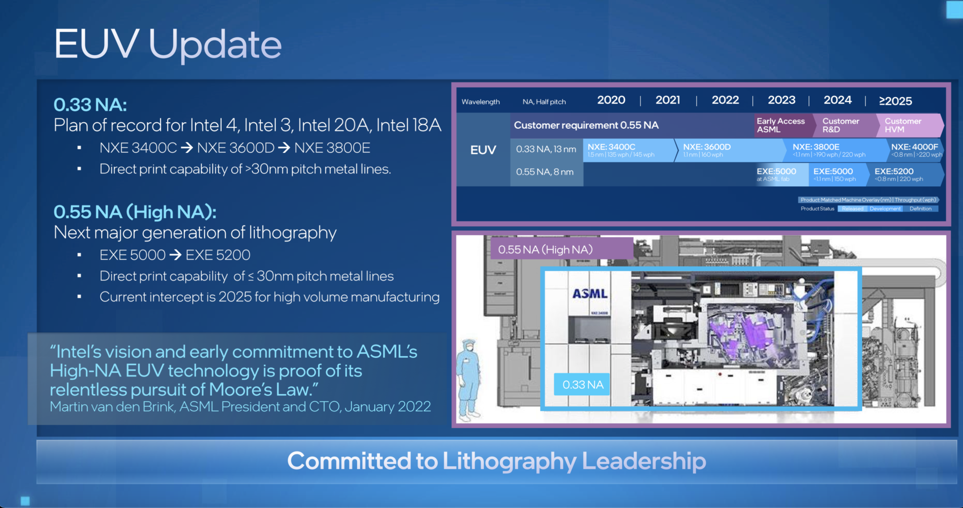

From their 2022 investor meeting https://semiwiki.com/semiconductor-manufacturers/intel/308311-intel-2022-investor-meeting/ they showed this:
Why is 30 nm their pitch limit? It's not from NA.
If Intel 18A minimum metal pitch is below 30 nm, they would be using (going back to?) multipatterning. This seems a little like history repeating itself.

Isn't 30nm approximate pitch limit for single exposure low NA EUV? I think it is. Going below will require EUV double patterning. TSMC 2nm will probably also require it, which is why it might be more expensive than 18A on pure wafer processing cost. Of course Intel has other issues that drive the cost up...
You can go beyond 30 nm like 28 nm or 26 nm and get the same results with Low or High NA, since the images would be formed the same way.
Stochastics seems to be the concern at even larger pitches than 30 nm. So again, the NA wouldn't help. In fact, the higher NA requires thinner resist, which makes things worse.
I just checked the 2022 Intel 4 paper, the 30 nm pitch M0 was done by SAPQ instead of EUV direct print, so indeed it was excluded from the >30 nm pitch condition. At SPIE, they had also shown defects at 32 nm pitch. Other metal layers with larger pitches such as 45 nm were done with EUV, though in those cases, the DUV alternative would have been simpler pitch halving rather than quartering.
I'm sure they're still trying to do 30 nm pitch or a little lower with direct print. But it's really the stochastic situation that will determine if it's viable.
