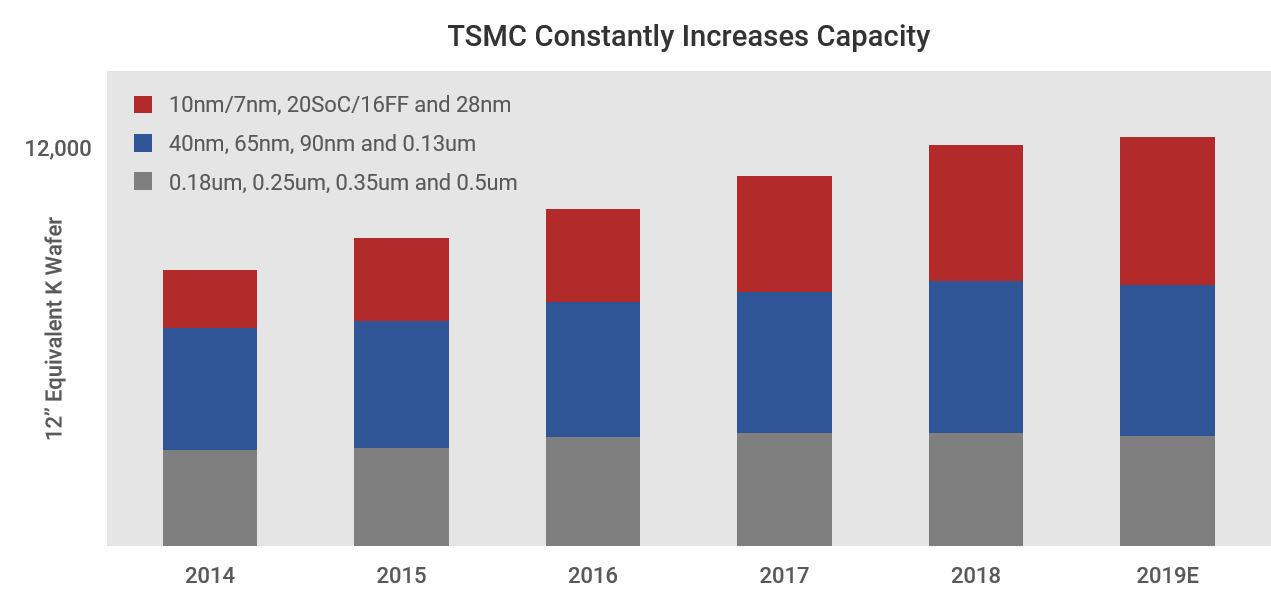

Scott Jones tracks 300mm and 200mm fabs so he would know the minute details. Not surprisingly 200mm fabs are still very profitable. Even TSMC does quite a bit of business at 200mm (6 fabs) and continues to invest.
