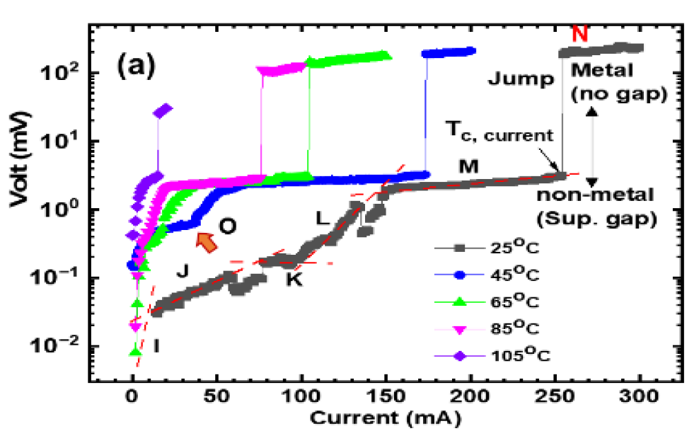

https://arxiv.org/abs/2307.12037 (the other LK-99 preprint)
The I-V curve indicates switching from an ultralow but nonzero resistance to a higher resistance, at a given current level, which is lower for higher temperature.
Rather than superconductivity, this looks like the RESET phenomenon in unipolar RRAM. It could be a correlated-electron phenomenon related to an insulator-metal transition.
