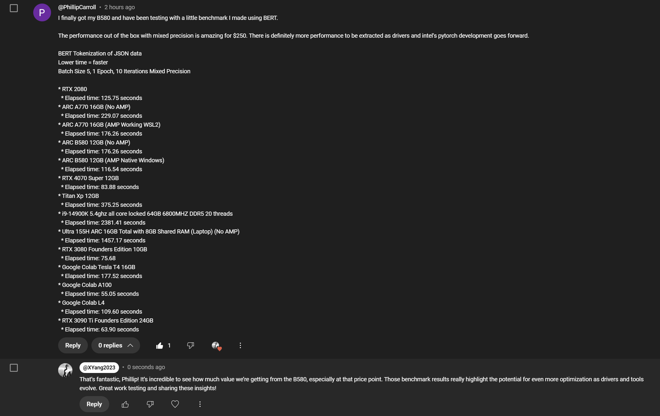

A viewer commented on my video with more PyTorch testing:
