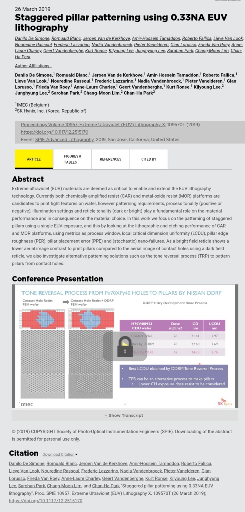

It looks they are still evaluating the process; the doses are already very high, much higher than what ASML uses to report throughput.

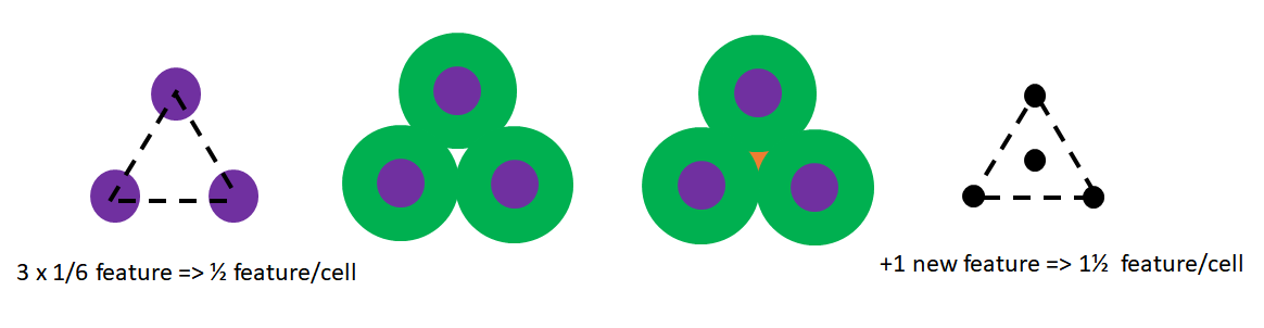

The feature is hexagonally arranged, so can actually be produced with 2 rounds of spacer patterning from a 120 nm x 210 nm starting array (technique already practiced by Samsung for a while). An older immersion tool may suffice.
