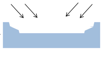

That approach also has the sidewall profile issue, shown in the paper 8 years ago: https://avs.scitation.org/doi/10.1116/1.4932161
The upper corners of the etch mask are being directly etched away.
A single conventional exposure with regular etching can always attempt the tighter tip-to-tip, it's just that the control is not satisfactory generally. It's unlikely their line elongation offers improved control, it's just a new technique with a different set of parameters.

The sidewall is ruined at the target area. SADP or LELE is for doublng features in same area.
Have you looked at the portfolio of EM images of the result of the tool? They have a 20:1 directional etch and do not ruin the endwall when they extend. It also has some interesting side effects like 90% reduction in bridging, and they show a variety of other creative uses for the tool.
You should give them some credit for doing their homework, not just slam it as equivalent to some research papers of the past. Looks to me like they have added a new, useful tool to the toolbox in the fab, and they have got some pretty clean results to show.
