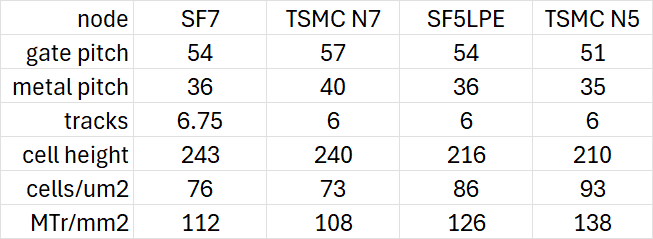

I went back to check the numbers, what I have is:
I am not sure if SMIC N+2 density was ever released or calculated?
N+2 is 93 mtr.
It has 63nm gate pitch and 252nm cell height which revealed by Techinsight.
118 mtr mean ~27% density improve, very huge.
Yeah, I remembered the gate pitch had been "abnormally" large, but actually it's just that SMIC density < Samsung density < TSMC density for a given process family or cluster.

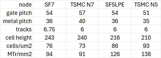

I used the formula in that article, but actually I applied it wrongly for the 7nm generation nodes since they were double diffusion break. Here is the correction:
Assuming SMIC has the same double vs. single diffusion break difference, N+3 should be more readily associated with the 5nm crowd.
To get away from these layout assumptions, I'd rather use minimum metal half-pitch as the defining feature, as that sets the main patterning difficulty.
Or maybe cells/um2 (1/gate pitch/cell height)?

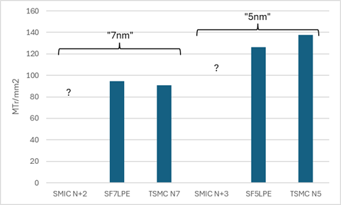

I'd picture it this way...
It seems like N+3 is truly G57H228 ( come from Techinsight decap data).
Hard to judge whether this is 5nm or not.
Techinsight think N+3 is 7nm scaled, not 5nm due to density is lower than 5LPE and N5: 120 vs 134 vs 145.
(And Techinsight list N6 at 114 mtr, so N+3 slightly higher than N6 but far inferior to TSMC N5)
But to me, N+3 M0 pitch is so impressive, which can be classified as 5nm node.
But M2 pitch only slightly reduce from 7nm node of 40nm to 38nm, not as intensive as M0 pitch scaled. Wonder why?

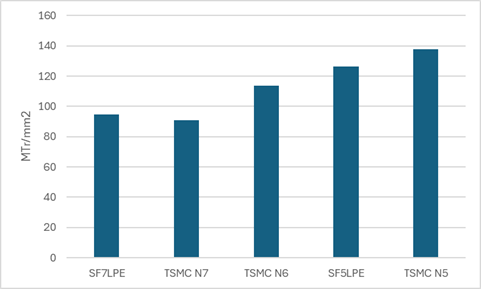

TSMC N6 changed diffusion break from double to single, that in itself is enough to put it above 100 MTr/mm2. So it is a noticeable jump in density from earlier 7nm. The design rules were (supposedly) the same as N7 though I think gate pitch shrunk to 54 nm to get the number below.
I had checked with the author, they may not be using the same ratio of FF:NAND. So absolute numbers may vary from source to source. But within a given author's consistency, the density ratios would be the same and still give the same plot appearance.
