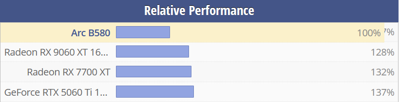

Relative Performance: 100% (1080P games)

Relative Performance: 128% (1080P games)

Relative Performance: 137% (1080P games)

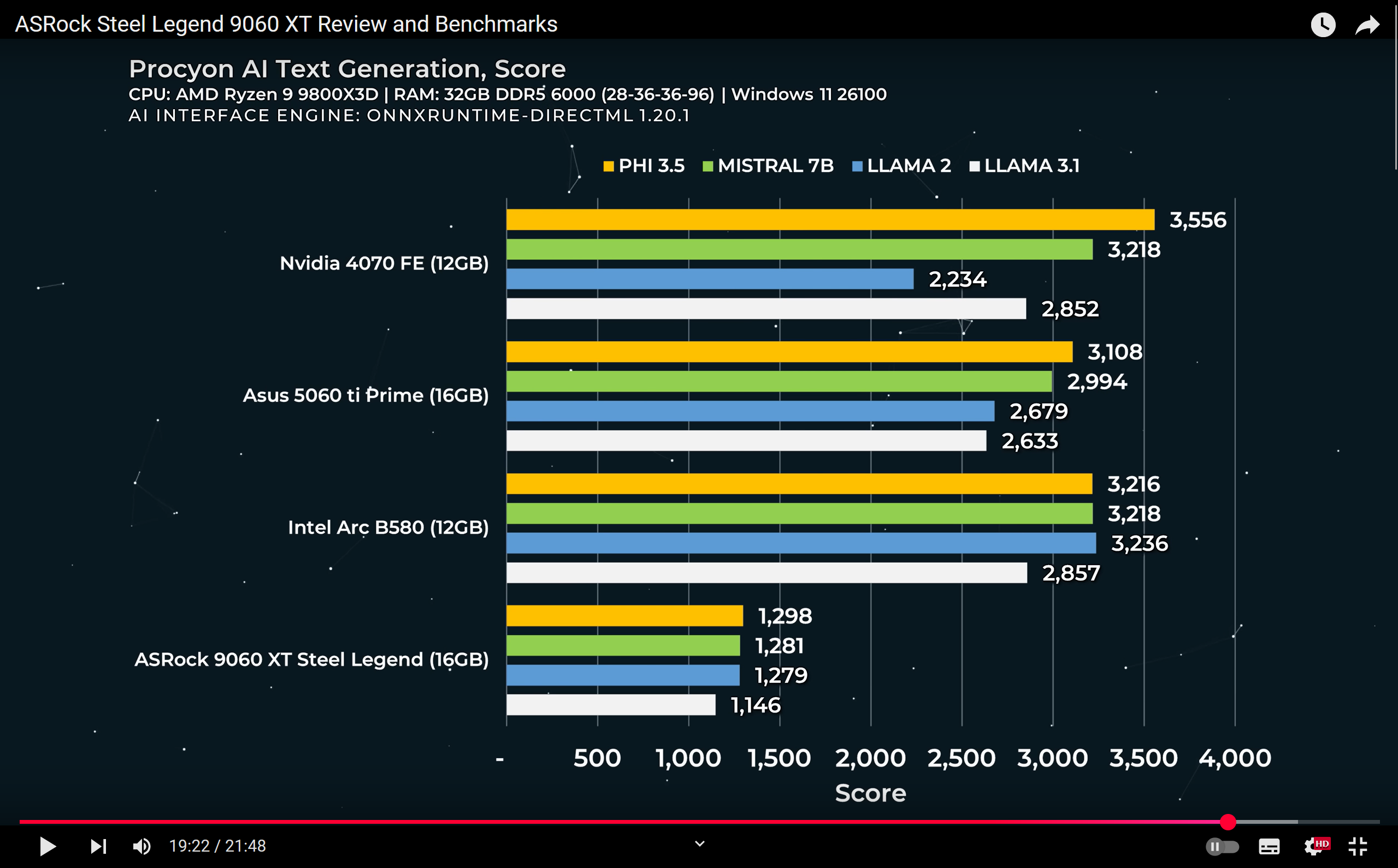

AI Benchmarks:
Source:

The AI performance is commendable for Arc but yes their xtor density sucks vs competition if they would have been able to take it to Nvidia level density it would be pretty good but maybe next generation

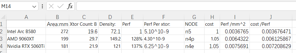

I have a table as following,
I assume N4p and N4E cost 5% higher than N5.(sorry, it should Perf/cost)
Let's get details.
Perf Per xtor benchmark is not important.
What's important is Perf/area.
well N5 -> N4 is a 6% shrink so the area would be around 256mm2 roughy on scaling it by that factor but i pretty much agree with you for BattleMage for cost i think they would charge around 10-15% more for N4P as it is clear 11% better in PPW and 6% denser than N5.
