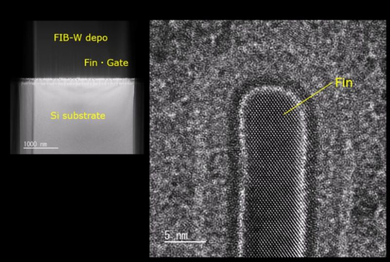

A TEM lamella of a 5 nm node FinFET was prepared in the Wg direction to contain just one gate layer. While backside FIB milling was performed to mitigate curtaining, 2 kV finishing was applied to reduce FIB-induced damage. Obtained high resolution TEM images clearly showed the shape of Fins with little FIB-induced damage.
