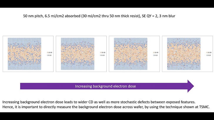

The secondary electrons from below the resist are obviously a very random, stochastic input image source in addition to the EUV input. But the image inputs do not stop there. The plasma environment above the resist generates plenty of exposing non-EUV, non-confined energy (VUV, electrons, hydrogen), which can even etch resist in real time during exposure.
