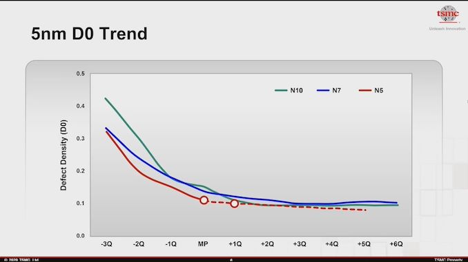

At the 2023 North American Technology Symposium (June 2023) TSMC stated:
“the D0 defect density of N3E is at relative parity with N5, matching the defect rate of the older node for the same point in its respective lifecycle.”
During TSMC’s 4Q23 earnings call (Jan 18, 2024), Wei highlights N2’s progress:
“N2 technology development is progressing well with device performance and yield on track or ahead of plan, and N2 is on track for volume production in 2025 with a ramp profile like N3."

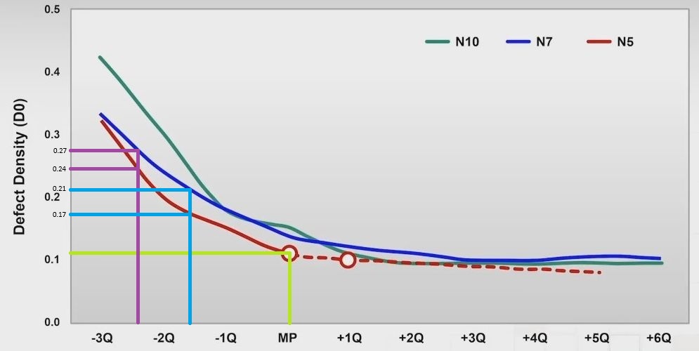

So N2 has a ramp profile like N3, and N3 has a ramp profile like N5, thus N2 has a ~similar ramp profile as N5, and according to C.C. Wei N2 is on track or ahead of plan.
Between on track or ahead of plan, lifecycle is -1.6Q (turquoise) or being late the lifecycle is -2.5Q (purple).
Whether N2 is closer to N5 or N7, on time, ahead, or late, still have D0 less than 0.30, likely (knowing TSMC), D0 is closer to 0.25.
That’s a lot of extrapolating, but that's where the fun is.
