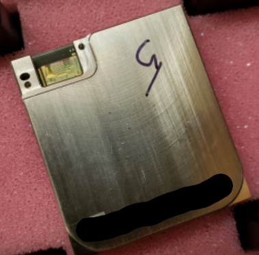

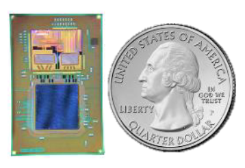

We already use 3D packaging, the 22FDX analog chips are flipped on top of a silicon photonics PIC, next to this on a common substrate is the flip-chip 5nm DSP. The RF traces between the ADC/DAC (on the DSP) and the 22FDX analog chips (on top of the PIC) are only a few mm long, bandwidth of these is >70GHz. This isn't really driven by the lower cost per mm2 of 22FDX compared to N5, but by the need to get the analog chips right next to the optical components on the PIC.
