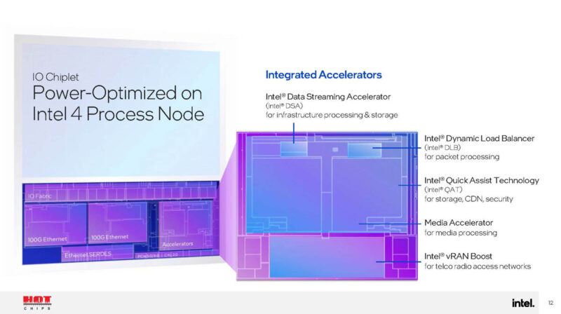

Intel 4 was chiplet only for Internal Intel design, no IOs etc for full chip wafer manufacturing.
Incorrect Dan. Intel 4 does have IOs. Even if you want to ignore the high speed D2D connections on MTL cpu die, FIVIR, PLLs, etc. The edge version of Xeon 6 has full ethernet and PCIE interfaces on an i4 IO die. Heck if you look at older intel roadmaps large die Xeon 6 was listed as intel 4 not intel 3. In addition to the intel 4 5G base station intel talked about last year, it is obvious that only the MTL CPU being on intel 4 was a conscious design choice from CCG rather than a technological limitation of intel 4 not being a "real" process technology.
They were barely half nodes much less full nodes.
Intel 4 240h HP cell vs the intel 7 HD cell was a similar shrink to N3 HD over N5 HD, and a larger perf/watt improvement than N5 vs N7. To call intel 4 a half node step over intel 7 is at best disengous. Intel 20A was also GAA and BSPD, so clearly a very different node than intel 3. Now if you want to call intel 3 and 18A "half nodes", sure no disagreements there. But saying an intel process technology isn't real because it only runs internal chiplets (something that 100% of even intel's TSMC products have) would be like me saying original N3 was never a real node because only Apple SOCs and intel SOCs have/will ever be built on it and because there is no RF capability on any N3 or N3E products to date. If I said something incorrect like that I would rightfully be called out.

I was talking about I/O support for a complex SoC type of chip not a chiplet but I could certainly be miss informed. Did Intel actually make a full chip at 4 or 20A? Or is it just theoretically possible that they could?
