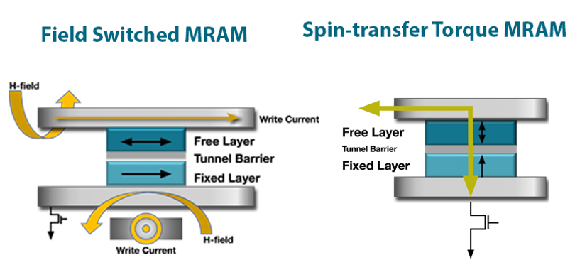

Off-chip toggle MRAM still has no alternative for high rate logging purposes, due to write cycles far surpassing NOR.

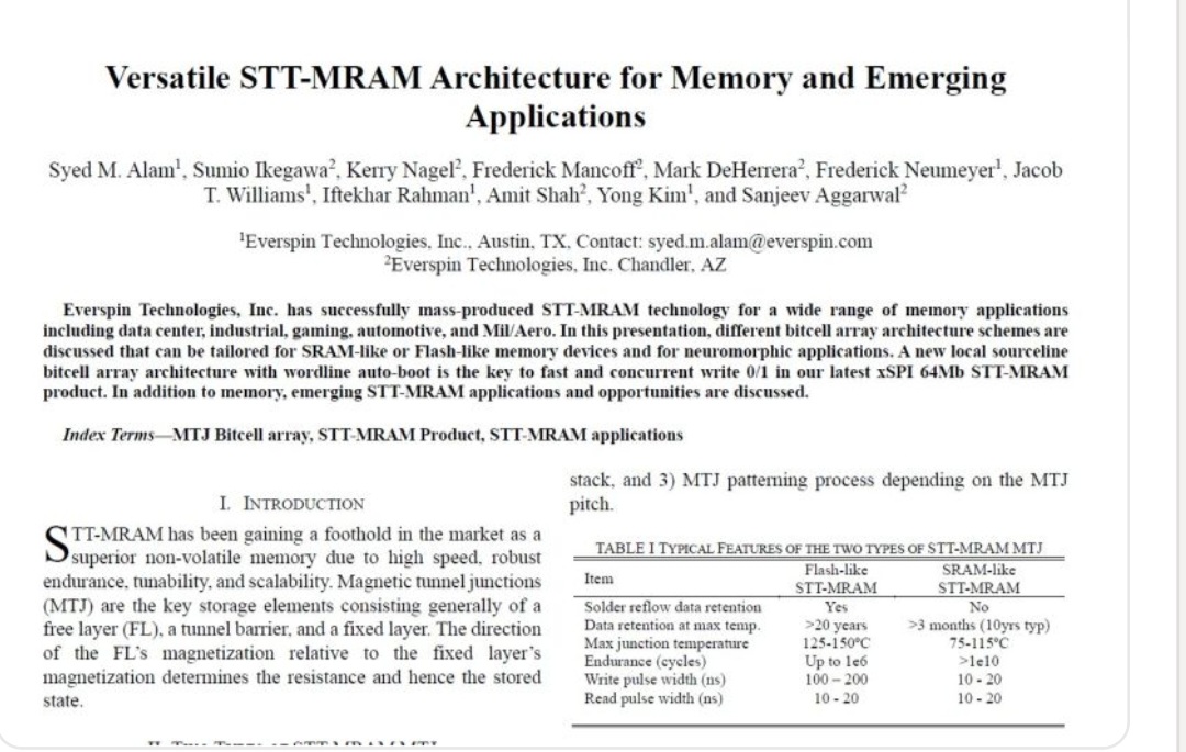

Not quite there for SRAM, not a sure case against RRAM or NOR either. High-retention current accelerating breakdown (limiting endurance) is the issue.
TMRC 2023 paper C3 https://sites.google.com/umn.edu/tmrc2023/
