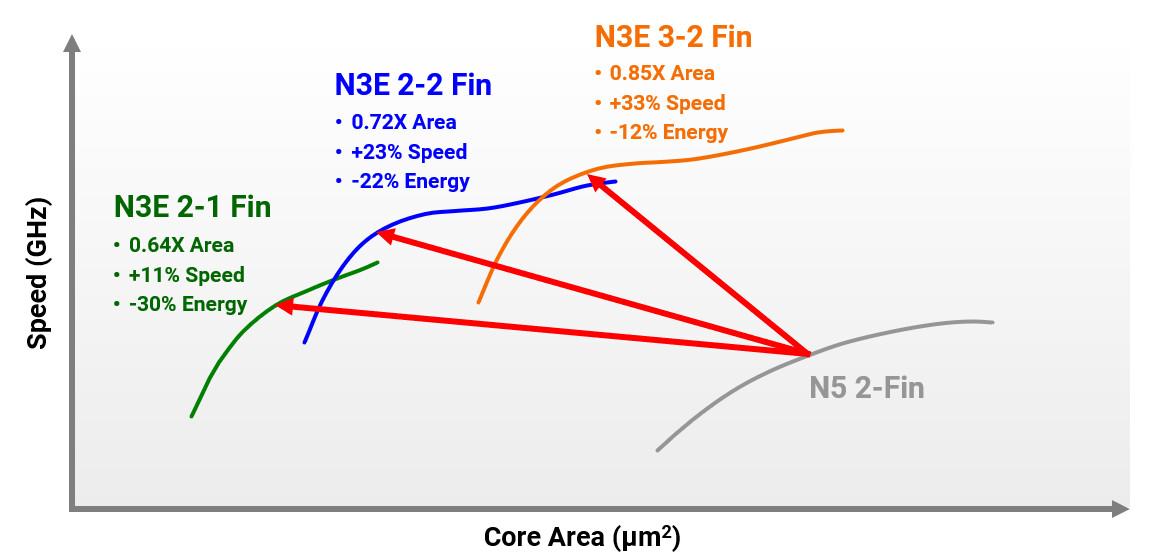

Would love his opinion. My less discerning eye says this sits squarely between N3E and N4P on a PPA basis. HD logic density same as N4P. HP density is much better than N4P and very close to N3/E. Both TSMC nodes likely win by a a very wide margin when it comes to characteristics mobile APs like (such as switching energy). And on the other side of things, Intel 4/3 have a MIM cap that is generations ahead of all other logic firms. TSMC also like half a node of an SRAM density lead on the N5/N3/N3E families. Considering that intel 4 perf/watt seemingly is splitting hairs with N4P in HPC scenarios, the fact that SRF can frequently beat Zen4 EPYC efficiency despite the inferior core arch, and I think it is fair to say intel 3 far exceeds N4P in that metric. Beyond that it is hard to say if it is at the level of N3E/P. Considering that intel said that the leader's best node in 2024 (which presumably means N3E) was about equal to intel 3 for perf/watt, I think it is safe to assume i3 at the very least isn't better.
The one oddity is the HD logic lib performance. I would not be shocked if you told me that little beast of a transistor had more performance than the minimum sheet width N2 transistor. Of course you would have higher power consumption and area, but I can't stop marveling at how fast that 210 is. I mean the N3E 2-1 is by TSMC's numbers the same speed as N4P's HD lib at iso power. Versus the N4P HP lib it would be slower, but that is totally fine (and expected) because you are getting lower area and less power. For the i3 210h to be that much faster than the i4 240h at same power while effective device width is reduced by 33% is simply insane. It's a shame intel CPU designers seem to rarely use HD libs. In a funny way it seems like AMD's products (which seem to only use HD cells but with uLVT/MIM/overdrive to hit high freq instead of relying on tall cells) would benefit from intel 3 more than intel's own products. :LOL:
I'd be surprised if AMD don't mix and match HD and HP cells in different blocks as needed -- why wouldn't they?
Bear in mind that the mixed-height FlexFin libraries also have tall multi-row cells for more complex cells like multi-bit flip-flops and complex multi-input gates. For example the 2-1 fin library (M143) is alternating rows of 1-fin (H117, non-critical paths) and 2-fin (H169) cells, but there are also dual-height H286 cells (1-fin row+2-fin row), triple-height H403 (2x1-fin+2-fin), and H455 cells (2x2-fin + 1-fin). I'm pretty sure the 3-2 fin library has the same kind of mix (H169+H221?), but faster and higher power.
ULVT is pretty standard for speed-critical circuits, also ELVT which are even faster (but leakier) for high-speed critical paths -- and then all the other four higher Vth for non-critical lower-power circuits, which is also where the mixed-height libraries come in to reduce area and save power. The design space is enormous, party time for the tools... ;-)
That would have been my thought too. But looking at teardowns I remember being perplexed that their N5P parts only seemed to have the 210h in the core area. Maybe the die to die phy would be different? The other babel about VTs and overdrive was mostly me trying to rationalize how they get the Fmax they do while only using the short cell. Intel mentioned that RC is now over half of the frequency response. Maybe this is just due to intel 7 using an inferior metallization scheme? Or maybe it is the high mobility PMOS that carries the day?
Other than the alternating CHs within a block that isn’t a finflex exclusive thing, no? Only very simple devices like a NAND would ever be the quoted short height yes?
