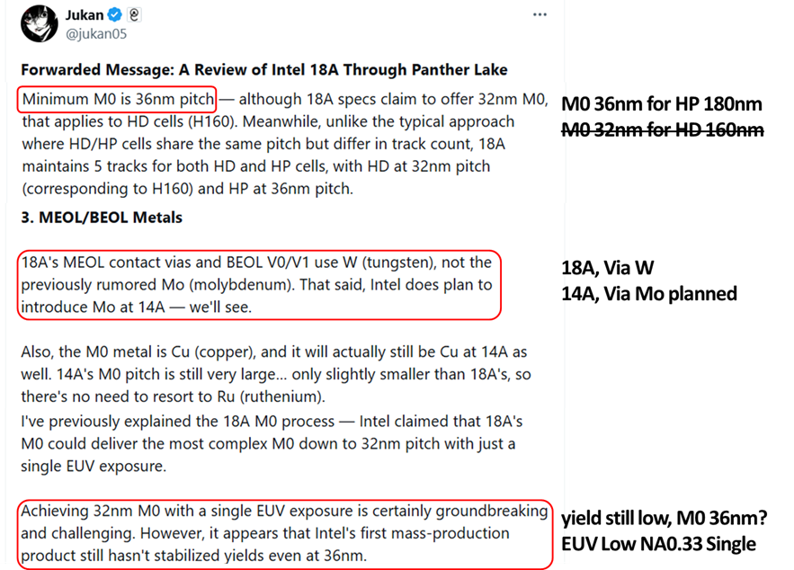

Some key Panther Lake design rules were posted on X:

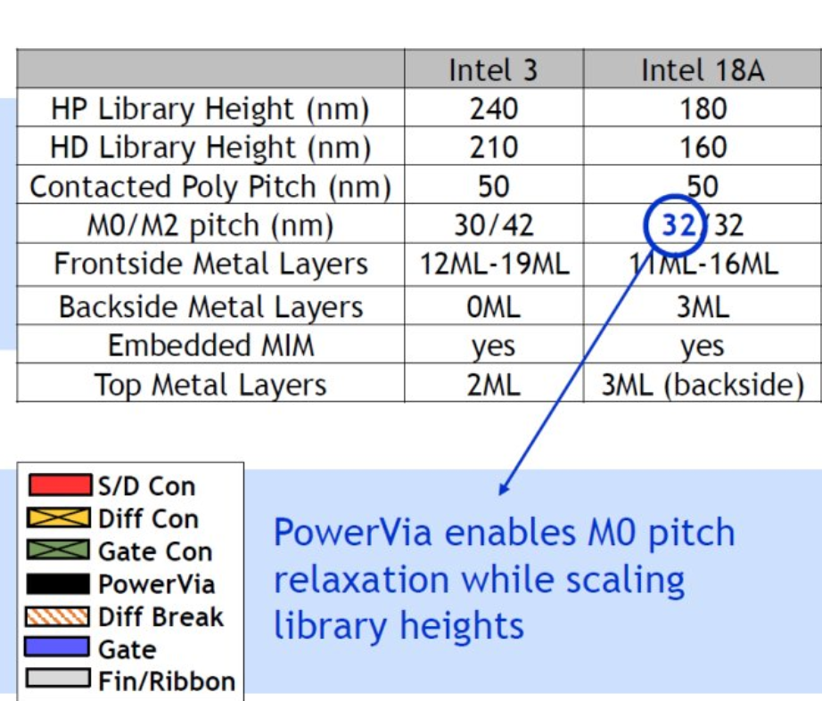

Minimum pitch 36 nm (7nm-class), density obviously helped by 5 tracks from backside rails.
I would like to point out few things
- Intel has traditionally used HP Cells in their Products. Intel 10nm -> ADL,RPL,TGL Intel 4/3 -> MTL/ARL.
- The decision to use HP/HD is on design not on foundry for what characteristics they want.
As for whether Intel can do 32nm direct print or not remains to be seen cause they didn't put it in any other product yet.
The article seems poorly written imo.
So is the HD cell more difficult to fabricate than HP cell? Due to the smaller pitch dimensions?
yeah smaller dimensions are more work especially 32nm single print
