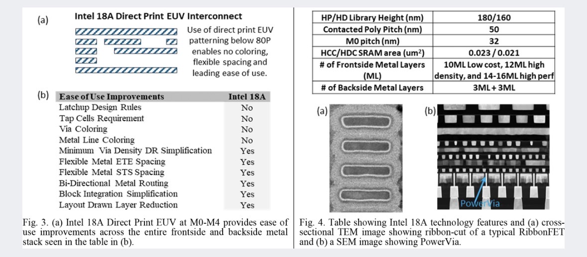

ARL has 17 Metal Layers
LNL has 20 Metal Layers
PTL has 21 Metal Layers
This is also very strange too….
Intel said FS 14-16 ML is for high performance, but PTL dose not pursuit high performance?
And why fewer ML (12ML) is for high density?

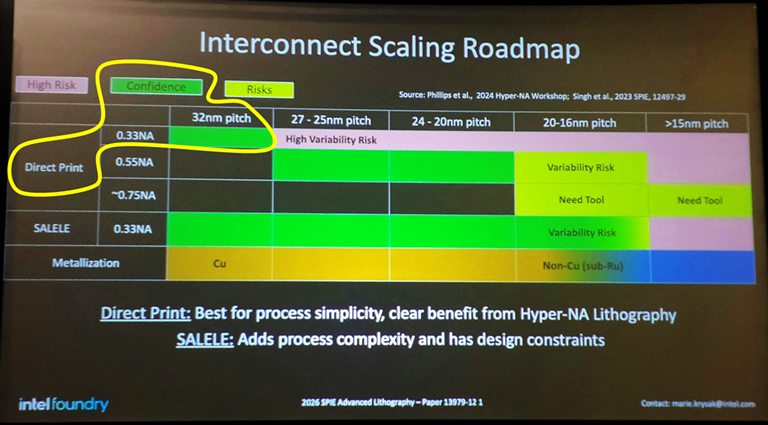

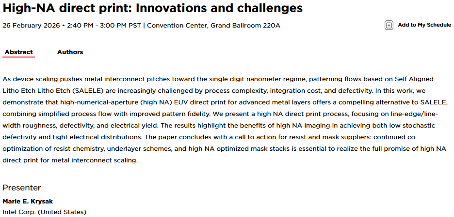

for BEOL M0 32nm with EUV Low NA 0.33 Direct Print, Intel R&D is confident but Intel Volume Manufacturing cannot yield? source = 2026-Feb-SPIE
for Intel 18A, Intel R&D was/is confident about 32nm with EUV Low NA 0.33 Direct Print, but can Intel Volume Manufacturing yield?
for Intel 14A, Intel R&D would be confident about 24nm with EUV High NA 0.55 Direct Print, but can Intel Volume Manufacturing yield?
by the way, Intel 14A PDK 0.5 is promised/scheduled to be delivered to customers in 2026-Q1
Nope, Intel 14A M0 is 28nm.

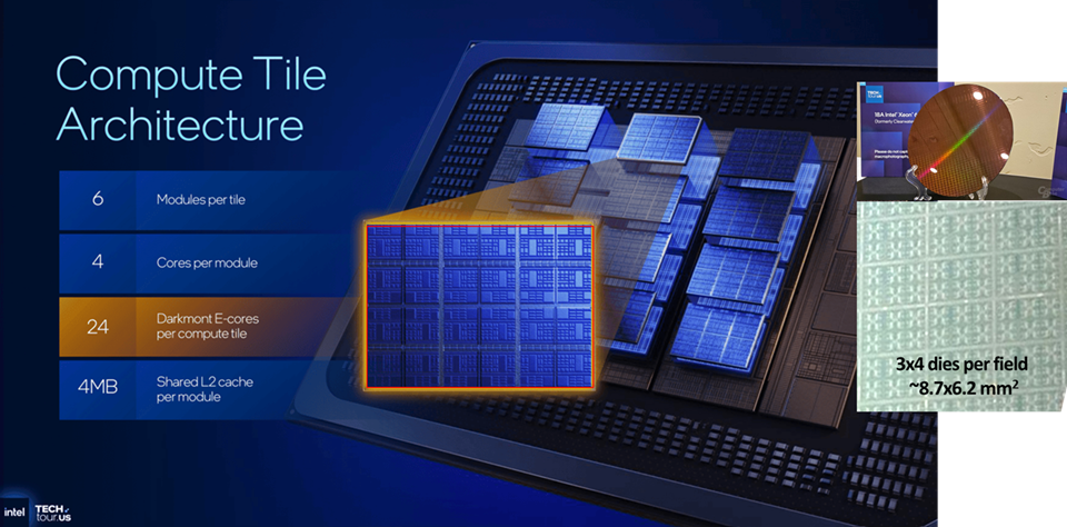

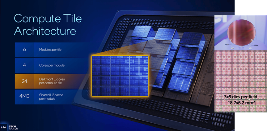

not new info, Intel 18A 1st chip = Panther Lake compute tile, 2nd chip = Clearwater Forest compute tile 3x4 dies per reticle field, each die of ~8.7x6.2 mm2, yield is higher for small dies than 1 or 2 large dies per reticle field, source = 2025-Oct-IntelTechTourUS, https://www.computerbase.de/artikel/prozessoren/intel-clearwater-forest-288-kerne-detail.94509/
Is this many chiplet design was built this way specifically because of the 18A target and yield curve / ramp considerations? I definitely get that overall this design could not fit within the reticle limit, but for instance it looked this way too on 10nm/Intel 7: Sapphire Rapids with more chiplets -> Emerald Rapids with consolidation and much bigger dies a year or two along the yield/ramp curve.
From a pure perf/W perspective, is it usually correct that the monolithic design wins out? For instance, Nvidia’s leading designs continually do reticle limit monolithic dies.

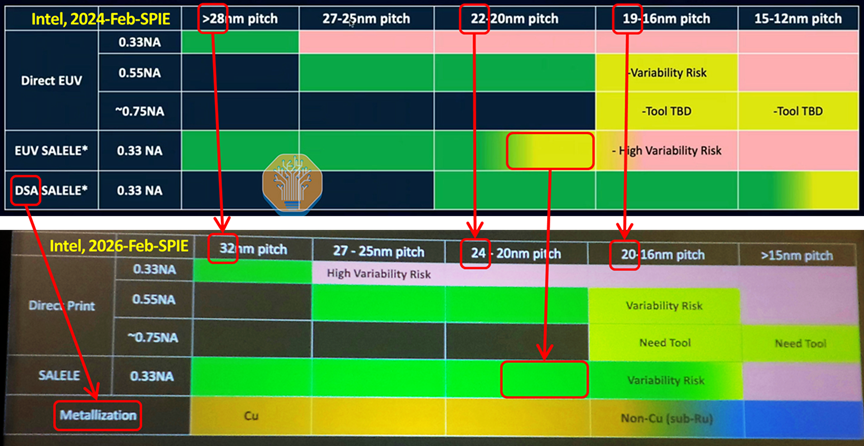

Intel from 2024-Feb-SPIE to 2026-Feb-SPIE, glad to see these progressions toward being realistic for volume manufacturing
from >28nm to 32nm, EUV 0.33NA Direct Print
from green-yellow to green, EUV 0.33A SALELE
from 22-20nm to 24-20nm, from 19-16nm to 20-16nm, BEOL M0 pitch
from DSA to Metallization, last row
