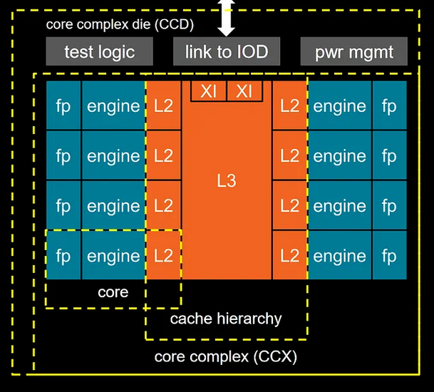

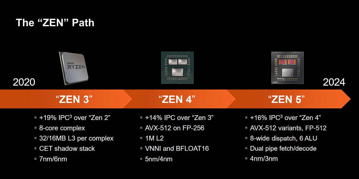

so AMD uses two Core complex(CCX) aka 8 Core Chiplets that are similar and binned differently that is one CCX can hit higher clocks and one CCX can't hit that high of a clock on one core they have different V/F curves . Here is how an AMD 8 Core Chiplets looks like. An AMD desktop CPU Contains 2 CCX and 1 IO Die containing IMC.

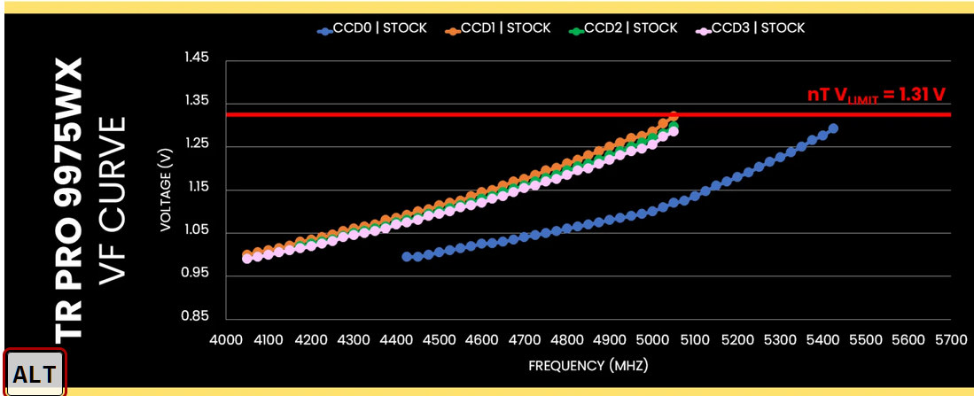

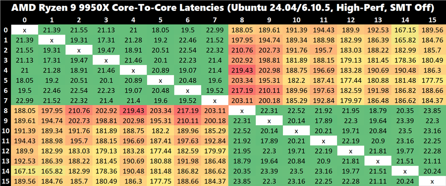

Here is a Zen 5 CPU with TWO CCX and IOD the problem arises when the core in one CCX has to access the data from another CCX it causes latency as the request has to route through IOD where the IMC lies to go from one CCX to another. This results in poor latency. Also i have added a curve for the different bins of Threadripper with 4 CCX.

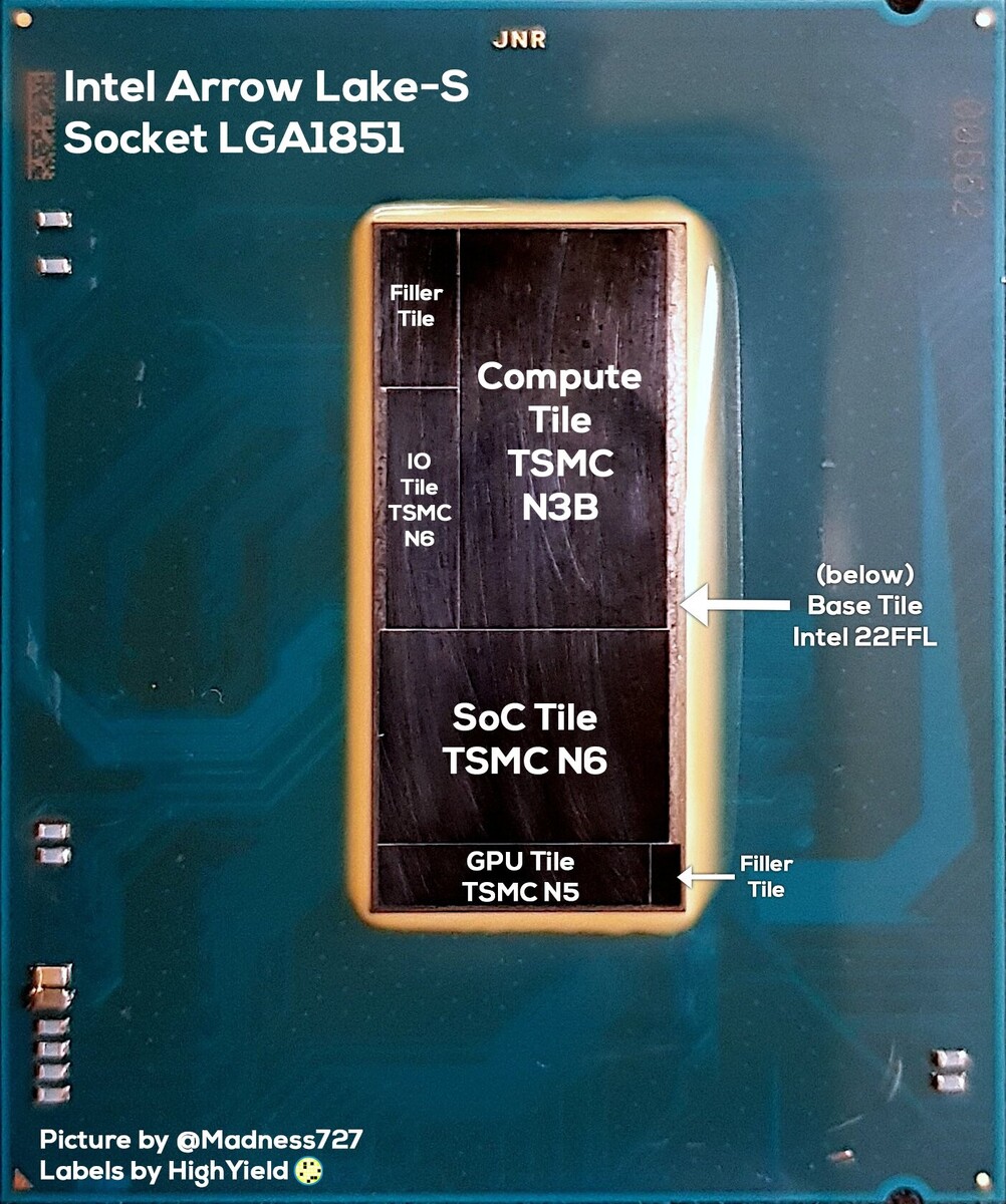

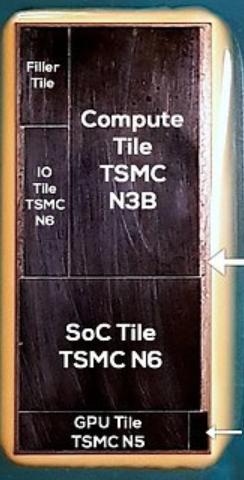

Now for Intel they also are based on similar principle they have an SoC die Containing IMC and a compute die containing the Cores but they only have a single Compute die or CCX in AMDs terms and a shared SoC die between different compute die.
The difference between AMD and Intel is Intel tapes out multiple compute die while AMD reuses the same CCX for all the Desktop SKU depending on binning and number of CCX but they tape out different dies for mobile.
Intel just uses two compute dies shared across Desktop and Mobile so for example ARL-H and ARL-S both share the 6+8 die while HX and S series share the 8+16 die with different SoC one with LP-E cores and one SoC without LP-E Cores. Of course there are different Binning for Mobile and Desktop. There is difference in Packing as well Intel uses exxpensive Foveros while AMD uses cheap packing.
