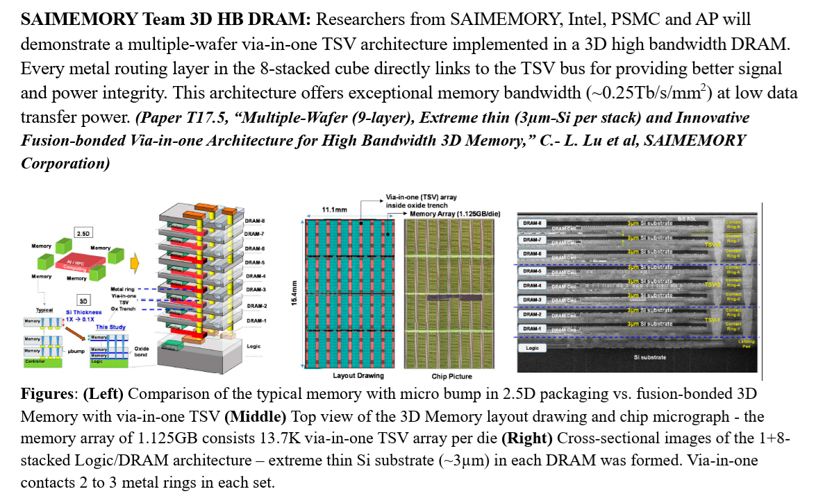

Intel and SoftBank, through their subsidiary Saimemory, have been developing an alternative technology to the popular high-bandwidth memory (HBM) to provide more bandwidth and capacity for memory modules used with powerful AI accelerators. At VLSI 2026 in June, Saimemory is scheduled to present a paper on the newly developed HB3DM memory, which is based on Z-Angle Memory (ZAM) technology. This name refers to the vertical (Z-axis) stacking of dies, similar to traditional HBM. However, Intel aims to achieve impressive results using state-of-the-art manufacturing technology. The first generation of HB3DM will feature a total of nine layers, stacked using a hybrid bonding technique for 3D chip placement. At the base will be a logic layer that manages data movement within the chip, with eight DRAM layers on top for data storage. Each layer will include about 13,700 TSVs for hybrid bonding.
This is basically HBM, next generation. It's still vertically stacked DRAM dies with TSV connections on top of logic base die.
Yay, Intel is getting back into memory! Or who is going to manufacture this?
I think Intel is just responsible for the stacking part. The DRAM is from PSMC apparently. The logic base die, if it had been made on Intel 18A or Intel 3, I'm sure that would have been called out.
Fred, can you please cite your source? I don't think ZAM is "still vertically stacked DRAM". There is a "vertical" component, but why is it called "Z-Angle" if it's not that different from HBM?
I thought ZAM had the HBM stack rotated 90 degrees and somehow bonded along the edge (saw some patents on this). But the figures in the article don't show this. Confusing.
This is from the VLSI Technology 2026 symposium highlights recently released: https://www.vlsisymposium.org/wp-co...hnical-Tipsheet-REVISED-FINAL-4.25.26-1-1.pdf
PSMC is a DRAM foundry: https://www.powerchip.com/en-global/services/foundry-services
Yes, I agree, I probably saw the same figures. So I think this paper is not about Z-Angle Memory. HB3DM is just something else they are trying. ZAM might still be under development. It is not mentioned in the abstract at all. TechPowerUp jumped the conclusion.
