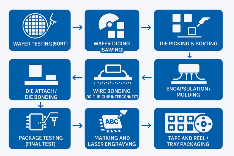

Ever wondered What Happens After Your Chip Leaves TSMC?
Most people know TSMC as the powerhouse that fabricates the world’s most advanced silicon chips—but what happens next is just as critical.
Here’s a quick breakdown of the journey a chip takes after fabrication:
1. Wafer Sort (E-Test):
🔗 Each wafer undergoes probe testing using Automated Test Equipment (ATE) to verify electrical functionality at the die level. Known Good Dies (KGDs) are identified using pre-defined test patterns and parametric specs. These test patterns are generated during pre-silicon stage using different Design-for-Test methodologies.
2. Dicing:
🔗 The wafer is then cut into individual chips (dies) using a diamond saw or laser. Precision is key—one slip and high-value dies can be lost. Protective coatings like UV tape are applied beforehand to avoid chipping or contamination.
3. Die Attach & Packaging:
🔗 Good dies are mounted onto a package substrate. Interconnection is achieved via wire bonding, flip-chip bumping, or Through-Silicon Vias (TSVs), depending on the package type (e.g., FC-BGA, 2.5D, 3DIC).
4. Package-Level Testing (Final Test):
🔗 Packaged parts undergo functional, parametric, and reliability testing. This includes power-on tests, scan chain validation, and timing characterization. This catches any damage that may have occurred during packaging.
5. Burn-In & Reliability Screening (as needed):
🔗 To screen for early-life failures (infant mortality), parts may be subjected to HTOL (High Temperature Operating Life) or HAST (Highly Accelerated Stress Test), especially for mission-critical or automotive-grade components.
6. Marking & Serialization:
🔗 Each packaged chip is laser-marked or labeled with traceable identifiers including lot, wafer ID, die position, and unique part numbers.
7. Tape & Reel / Tray Packing:
🔗 Devices are packed into JEDEC-standard trays or tape-and-reel formats, which are ready for pick-and-place machines in final system assembly.
8. Logistics & Shipment:
🔗 Finally, the chips are shipped to OEMs or system integrators (like Apple, NVIDIA, AMD) where they’re assembled into consumer devices, data centers, and more.
It’s a long journey from wafer to widget—and every step matters.
💡 Next time you’re holding your smartphone or powering up your laptop, remember: that tiny chip inside took a global, high-precision journey to get there!
