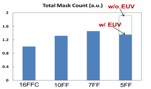

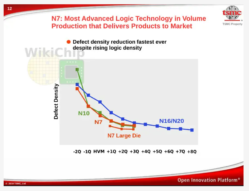

The increasing cost trend is unavoidable but the expected yield/defect risk from having more mask steps by itself seems disproven by none other than TSMC:
Source: https://fuse.wikichip.org/news/2567/tsmc-talks-7nm-5nm-yield-and-next-gen-5g-and-hpc-packaging/

The increased cost trend is unavoidable but the expected yield/defect risk from having more mask steps by itself, seems disproven by none other than TSMC:
To me, what this shows is increasing process capability and better integration to make up for higher process complexity. Obviously there is no way to know what parts of a given node that TSMC had to work the hardest to get working; but it is possible that this plot is just showing TSMC becoming better at applying MP techniques or getting to grips with finFETs. Either way all else being equal, more process steps will always lead to more defects (even if you can get each of the added steps to a very low number of added defects). All else NOT being equal, it is of course it is always possible for a flow with a large number of steps with low defects per step to beat a shorter flow with more defects per step (23nm metal paterning with direct EUV vs SALELE is an easy example). Additionally this plot does not show DD at the beginning of TD nor absolute values which I feel would be a key parts for this discussion.

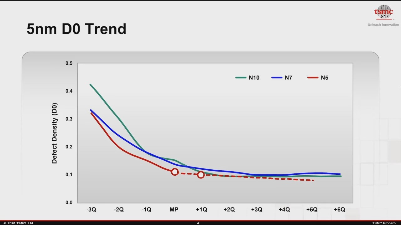

Given the limited public data to work with I suppose the N7 vs N5 DD trend immediately before HVM readiness also acts as a counter point (even if I don't really like these plots due to the unknowns I listed).
