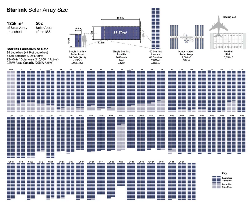

By the way, each Starlink v2 mini satellite's solar array is over 100m², they produce over 25kw in sunlight. Starlink v3 for Starship is supposed to be over 120kw. To date, there is nearly 0.4km² of solar panels in space from SpaceX alone, over 100MW of solar in space. This below picture is from 2023, they have over 9300 satellites in space now!

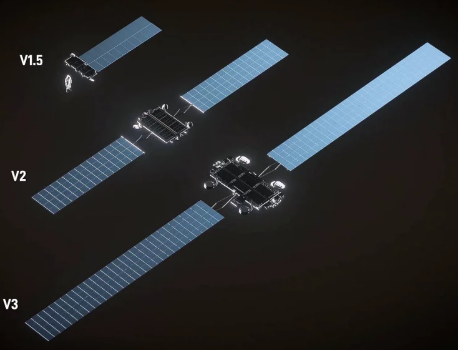

I’ve seen several estimates for the solar panel output of Starlink V2 and V3, and some of them are much lower than what you mentioned. Since Starlink doesn’t publish official numbers, it would be interesting to explore this a little bit more. A data center in the space needs to spend a significant amount of electricity on orbit keeping and communications, things that ground based data centers don’t really have to worry about. That makes the power budget especially interesting.
I was in the same head space, but it looks like the V2 / V2 mini satellites significantly upped the power vs. V1. 20-35 kW seems quite likely:
Here's a Gen 1 estimate analysis saying 7.5kW: https://www.linkedin.com/pulse/starlink-solar-module-answer-power-space-stan-herasimenka-7anfc/
Gen 2 solar arrays have "more than 4x the surface area" of Gen 1.5: https://spaceflightnow.com/2023/02/...batch-of-larger-upgraded-starlink-satellites/
This paper says Gen 2 has ~ 105m2 of solar panels, or about 10% less than the Spaceflight now Article implies: https://www.nasa.gov/wp-content/upl...rt-final-tagged-approved-1-8-24-tagged-v2.pdf
P.S. Of course this is "peak" power - radiation in space can damage panels a lot faster than weather on Earth, and the Starlink satellite is unlikely to be capable of cooling this peak power.
v2 mini has a 105m² surface area solar array, 1361w/m² solar irradiance in LEO, conservatively estimate 20% efficiency, +28kw peak. Published figures for the argon hall thruster is 4.2kw, it's mostly used initially for the first few weeks to get them to their orbital altitude shell when the satellite isn't active, once it's in orbit, it's only used intermittently. Right now, current gen Starlink satellites are essentially orbiting cell phone towers but once v3 satellites are up, they'll be like glorified fiber optics CO nodes, just one step away from a datacenter.
As for the output of those solar arrays, ever since they made the change from open book to shark fin configuration to minimize solar glare for astronomers (in addition to implementing the foam visor), the output will drop since the panels are perpendicular to the earth surface, i.e. output will be the least when they're directly between the earth and the sun. The simple solution for power is just make the solar array bigger, which is exactly what they're doing for v3 satellites. Another would be just using a polar sun synchronous orbit where the panels are always facing the sun, but I'd imagine such an orbit would get crowded pretty quickly with a million sats. :ROFLMAO:

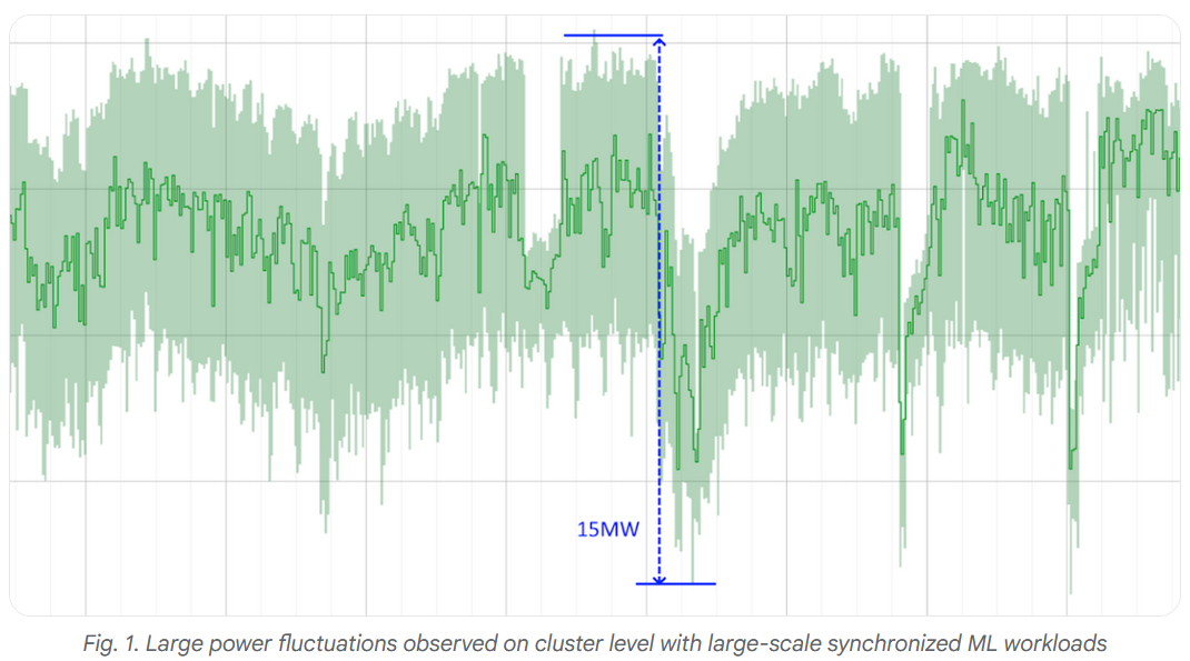

Not sure about active use times, there's a few charts out there, but the bigger problem with AI is the short peak-to-trough intervals on the order of milliseconds. This is problematic for the terrestrial grid and cannot be resolved without massive battery storage, but becomes less of a factor if all power will be provided through a battery in orbit.
Refer to this link for more on that: https://www.nerc.com/globalassets/w...ristics-and-risks-of-emerging-large-loads.pdf
