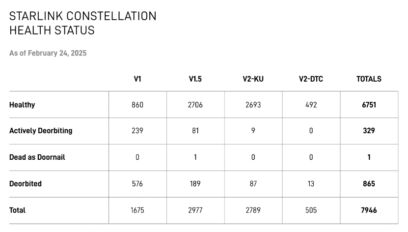

The FCC application calls for orbits from 500km to 2000km, the latter of which approaches MEO. There's more concern about damage from the Van Allen belt and energetic particles higher up, so one more factor to consider when going up. As for decommissioning and deorbiting, that's something they've been spending a lot of time and focus on since it directly impacts their future. I believe they've only had one, at they put it, dead as doornail satellite to date, the rest have been deorbited or are in the process of being actively deorbited. Their hall effect thrusters use only $10 worth of argon gas per satellite, their relentless effort to reduce cost is, quite impressive.

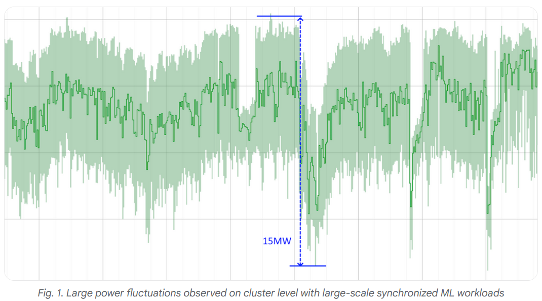

Not sure about active use times, there's a few charts out there, but the bigger problem with AI is the short peak-to-trough intervals on the order of milliseconds. This is problematic for the terrestrial grid and cannot be resolved without massive battery storage, but becomes less of a factor if all power will be provided through a battery in orbit.
Refer to this link for more on that: https://www.nerc.com/globalassets/w...ristics-and-risks-of-emerging-large-loads.pdf

If the satellites can be positioned in the orbital band over the poles which always sees the sun then the need for batteries disappears -- yes they'd then have to hop via other global-coverage Starlink satellites to get to worldwide users but this is already happening. The short-term power peak-to-troughs can be managed with small/light supercapacitors if no long-term (hourly/daily) storage is needed.
