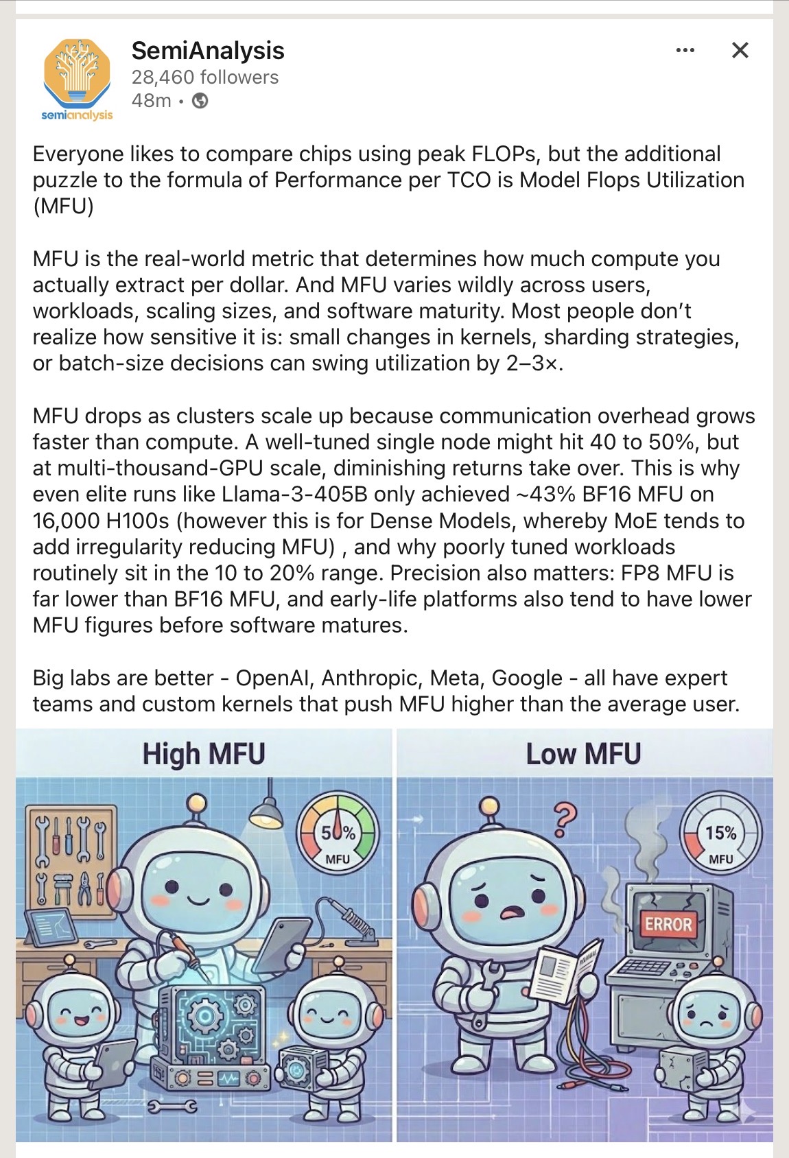

Going to throw one more insight into the mix on optimizing for AI data center inference. The raw peak aggregate compute/processing/access/memory capabilities don’t guarantee performance. Flexible high-capacity connectivity and clever usage of those compute / memory resources is needed in the data center setting to keep utilization of those resources high.
