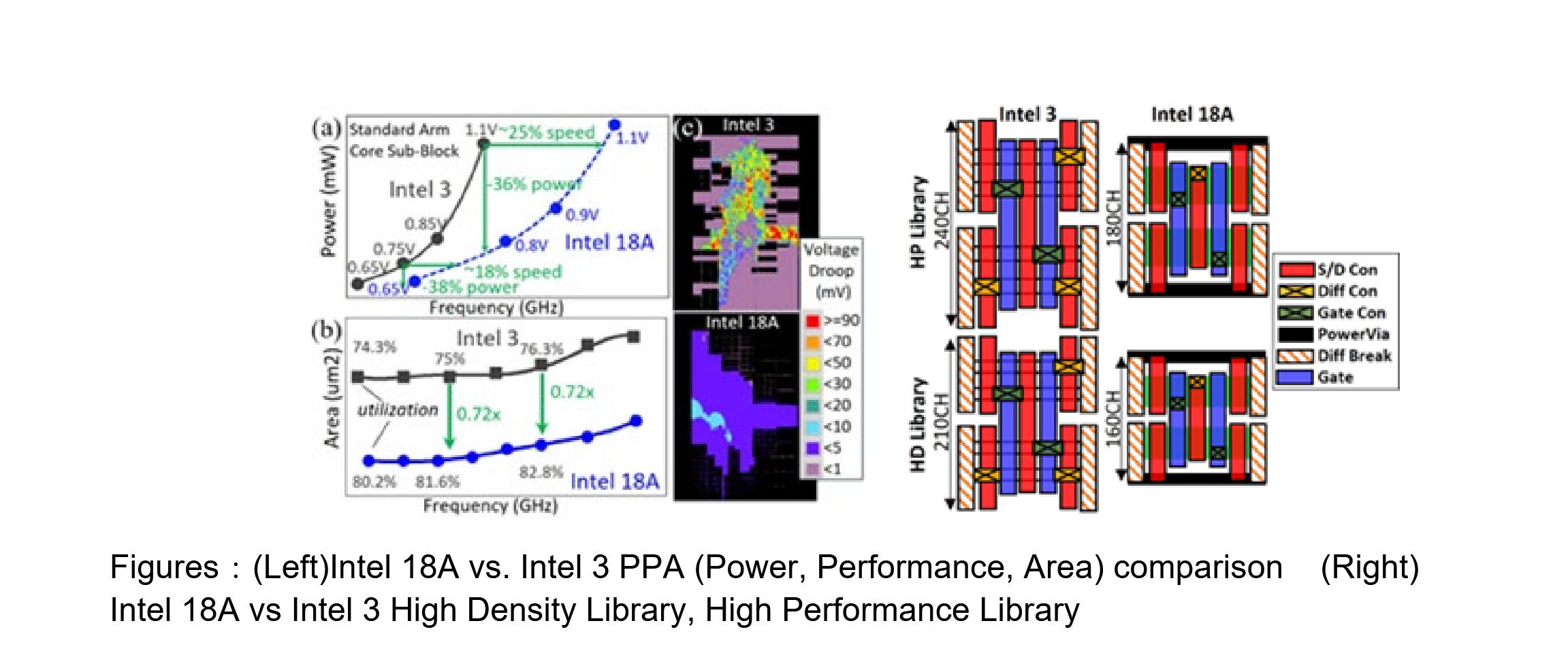

An advanced Intel 18A technology featuring RibbonFET and Power Via provides over 30%
density scaling and a full node of performance improvement compared to Intel 3. Intel 18A
offers high-performance (HP) and high-density (HD) libraries with full-featured technology
design capabilities and enhanced design ease of use.
Figures:(Left)Intel 18A vs. Intel 3 PPA (Power, Performance, Area) comparison (Right)
Intel 18A vs Intel 3 High Density Library, High Performance Library

Very nice. It looks like a >= 10:1 voltage droop reduction.. That should help a lot with both mobile/lower power threshold voltages and higher end desktop/workstation performance.. (Overclockers will love this)

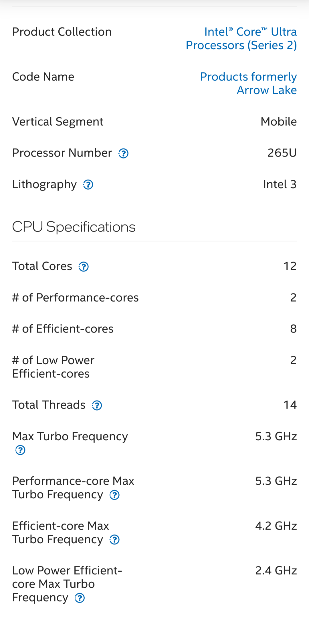

Top Frequency part shipped on Intel 3 is 5.3 GHz

Maybe I don't understand what you are saying but the Vdroop isn't super useful for low voltage (like Xeons or most leading edge foundry customers) situations. The bigger benefit is for reducing high V heat/power (desktop and laptop CPUs); at least that is my understanding. Low threshold voltage operation is a device property and is helped by things like lower leakage to help offset the smaller V wall between off and on at that low Vt. Meanwhile the Vdroop is a measure of how much voltage you are losing from electrical resistance in the metal stack. So that improvement is expected from BSPDN and isn't particularly special. Based on the thermal situation with BSPDN I would need to see actual products to make the determination if desktop and OC parts would like 18A. I suspect they won't because those parts have ultra high thermal density. I suspect 18A's sweet spot would be low voltage/low thermal density HPC (server CPUs and GPUs). But maybe the leakage will be too high for it to be perfect for that and maybe it is more comfortable with laptops where it is high voltage but thermal density isn't at surface of the sun levels so Intel's BSPDN thermal mitigations can handle it.
