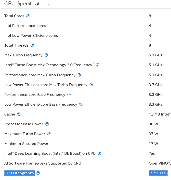

Silly question - where is N3B on the complexity scale vs N3 and N3E?
Not a silly question, as the terminology is garbled depending on how you talk to. "N3B" is "N3". "N3B" is not an official term you ever see in any of TSMC's official documentation. To them there is N3 and there is N3E and its successors. N3B is a shorthand some people like to use to specifically call out the original N3 from the rest of the N3 family, so there is less ambiguity about what you are talking about. Generally I say N3 to mean what others call N3B and I say N3E family to refer to N3E, and its related processes (but I'm not perfect, and occasionally I say N3 as a catch-all for all of TSMC's 3"nm" class process nodes). Not that there is a huge PPA difference between N3 and N3E anyhow. Actual N3/N3B products released to market in 2023 had an optical bloat to shore up yield risk that for all intents and purposes made N3 have near enough to equivalent density compared to N3E (not sure if Intel's 2024 products also use an optical bloat or if they are at the intended feature sizes as I haven't looked through the teardowns yet). I also just think TSMC kind of did N3E dirty by over emphasizing certain aspects of N3 to make it look better than it was in practice and making N3E look worse by comparison.
Just between you and I Xebec, N3B is what Apple used, it is the first version of N3. Apple gets a custom version of TSMC processes by contract that are specific to Apple requirements. Apple has what you call a "most favored nation contract". Apple gets first access and best pricing. When TSMC speaks about process roadmaps they do not include the Apple versions which is cause for confusion with the media.
Apple may have their own optimizations, but the process is largely indistinguishable from the perspective of fab process. In fact, the initial process Apple uses are always strictly inferior to the more mass market follow up. If you look at A14's N5 vs N5P that all others and Apple A15 used, the process was under worse control and has higher capacitance. FWIW, Intel also used their own HPC tuned version of N3/N3B.
