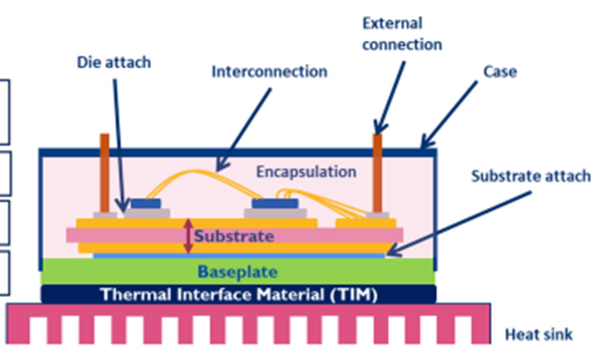

Please see the picture below:
The substrate consists of a stack of Cu-Ceramic-Cu.
1) Has the substrate the same function for power modules as the leadframe has in discrete devices (connect the "die" to the "outside world")?
2) Why is there Cu on the bottom of the substrate aswell? There is no electrical conductivity necessary (or even wanted). Does it only have to do with the CTE of the materials?
3) What is the main purpose of the baseplate? I guess it is to have a "solid foundation" for everything above but is it not possible to make the substrate "strong" enough to remove the baseplate and connect the substrate directly with the heatsink via the TIM?
Thanks for your help as always.
Regards,
Tobias
No, it has no conductors. It has to beryllia ceramics is there only as a heat conducting insulator.
It prevents BeO2 plate from cracking by equalising the bending force from top copper plate from below.
Yes, more stiffness. I think the module image is rather outdated in comparison to the leading edge now. Wire bonds on high power modules these days are usually replaced by solid copper plates.
