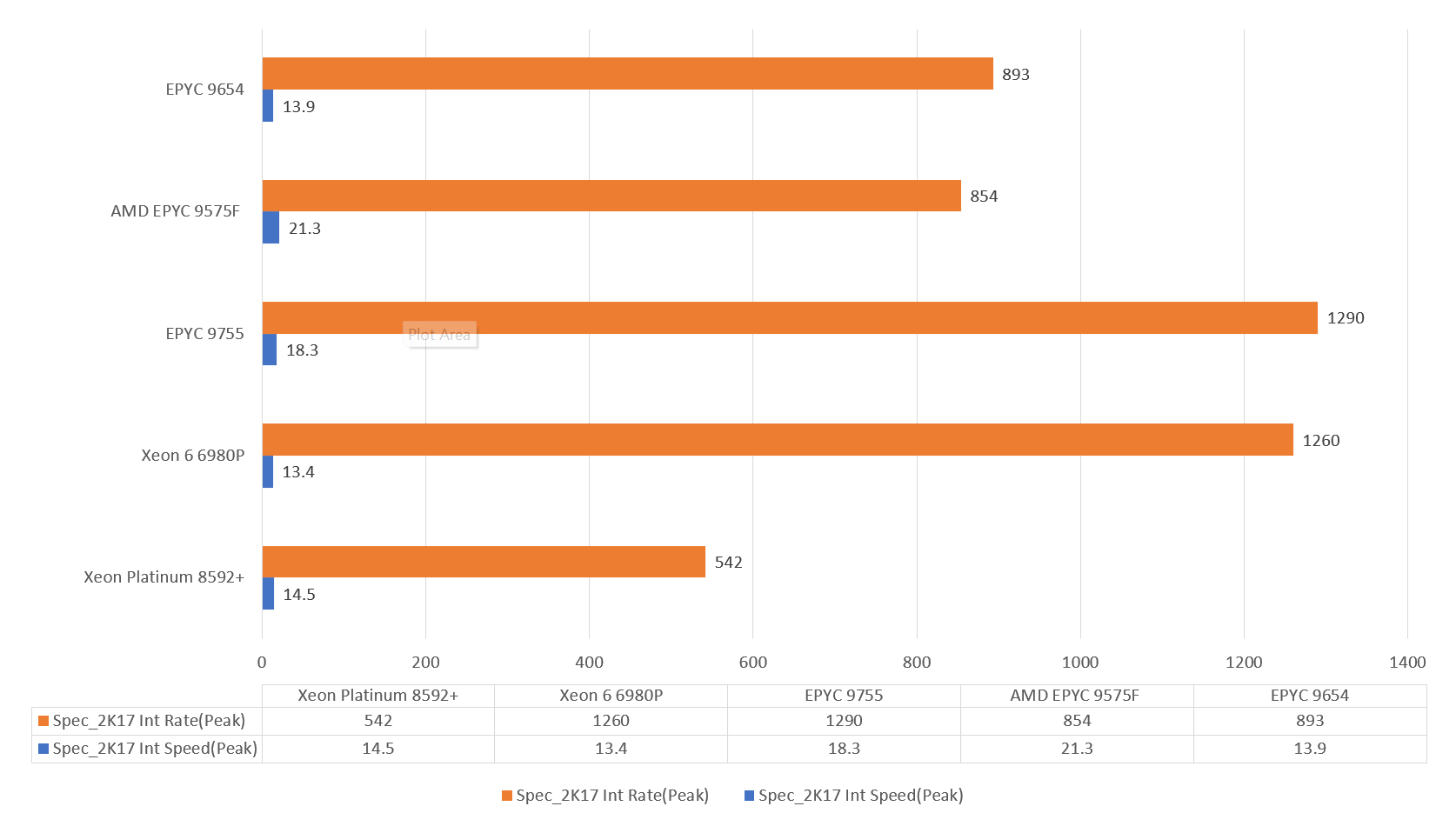

That's a 2S system a 1S system is only 20% behind also a 64 Core system is slightly behind a 128 Core system consider the workload geometry.
This is the industry standard SpecINT benchmark for a reference point using their own respective compilers.

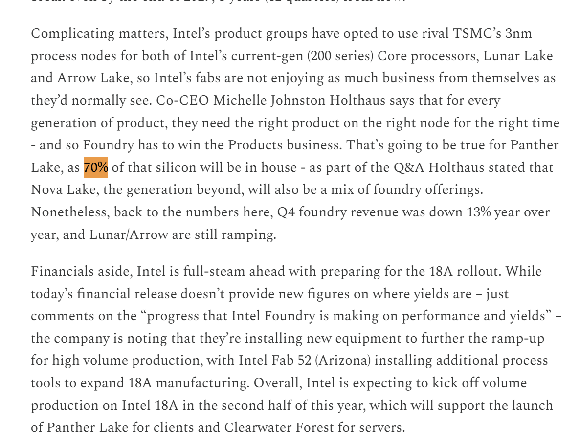

My own coverage of Intel and Intel's financials. Literally in the call and every conversation I've had with MJ and other execs.
@Daniel Nenni iirc they said 70% of the silicon of Panther Lake would be Intel. They might be including EMIB/packaging in that number.
from https://morethanmoore.substack.com/p/intel-2024-q4-financials
We're expecting Panther Lake to be commercial by end of year, CWF early in Q1. Ramp in this case really means 'achieved retail-class silicon', something like a B0 or B1 after the ES/QS cycles. Then it'll be put to the fabs, spend 3+ months before it's ready, and go to OEMs/retail.
They are not counting their Base die otherwise it would be >50% ARL SIlicon on Intel cause that tile is bigger than all the TSMC pcs combined in terms of area.

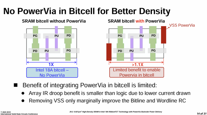

Odd report: PowerVia didn't help bit cell density, made it worse in fact.
Why would it? FEOL is very crowded on SRAM compared to logic (where the BEOL is oftentimes the more congested part). Powervia and BPR takes up space besides the transistors and if you were already at the narrowest nanowire sizes you can't just narrow the nanowire to reclaim the space of the nano TSVs. A backside contact should in theory eliminate this concern while also being a higher performance solution (less capacitance and shorter/lower resistance). So I would assume a bitcell with BS contact shouldn't have that regression. Either way I thought for memory arrays the power for a bitcell comes in via the bitline and wordline. Since the bit/wordlines run across the whole array grid/are a signal layer that would have been running on the front side it only matters that you have the BSPDN supplying power to the bitcell at the array perimeter yes? Beyond that you are placing powervias that aren't actually removing power rails (since SRAM bitcells outside the array edges don't have power rails) and should by extension be worthless. I assume the killer application for SRAM scaling is once you start seeing backside metal layers evolve to include backside signaling and then moving the wordlines to the backside and having backside contacts supplying power at the array edges instead of the more conservative NPR or powervia schemes. But I'm not an electrical engineer so maybe my understanding of SRAM bitcells is incorrect.
I'm not saying it couldn't have been expected, just that it was odd to put this counter-spin to PowerVia at this time. I guess it means PowerVia will only be implemented in non-SRAM sections of the chip.
Fair... Although with the technologies speaking for themselves/already demonstrated (behind closed doors and at conferences). It isn't like Intel needs to hide that information for an industry white paper. While armchair experts might quibble about is BSPDN worth it. The actual logic players all know that it is essential for continued scaling and don't need a sales pitch to continue with BS metallization R&D. I would also guess most of the attendees probably knew that without having to see it spelled out for them and then reverse engineering the logic behind the result like I had to. Combine that with the point being to teach and show results and it feels like it would be against the spirit of the conference to not talk about all aspects.
Also an interesting find I just found was then Intel 4 plus powervia SRAM which used the same powervia around array scheme:
Intel said they were implementing it on the periphery CMOS and the bitcells along the array edges.
If powerVia doesn't benefits SRAM does it means that A16 will not have SRAM bitcell decrease as well?
It doesn't benefit the bitcells, the SRAM macro still benefits. As for A16 it uses a backside epi S/D contact that is completely under the Xtor rather than besides it (thus not constricting nano sheet width). Since as I said the SRAM bitcells don't have power rails there should be no benefit. However since the BS contact is fully below the Xtor you shouldn't see the area penalty for bitcells that do have a BSPDN. I assume you need to start seeing backside signaling first before backside metal layers can reduce bitcell area.
Back to specifically A16, array control logic should see a benefit if the PDN is dense due to the resulting logoc cell utilization increase. But otherwise A16 shouldn't show a huge benefit in that case because it doesn't seem to be fully taking advantage of all the possibilities BS contacts or even BSPDN could offer in the name of easy design migration from N2. Assuming TSMC A14 doesn't have with and without BSPDN options (like how we will have N2 AND A16) then I would expect that there would be a large periphery scaling but minimal bitcell scaling (unless they implement a BS gate contact so they can do BS wordlines).
