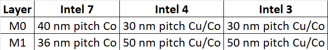

Good example is M0 patterning. On Intel 7 that is 40nm if memory serves with spacer based pitch division. Okay sounds doable with dry DUV (160nm core feature) and with way more etch, dep, polish, and metrology tools to form the same feature. Intel talked about 18A using direct print EUV for fine pitch metal layers at SPIE. There is simply no way to carry over all of that extra dry DUV tools and extra supporting hardware. Also what is good is now different. That SAPQ process would presumably have to deal with much greater aspect ratios and very different hard masks and chemistries.
The M0 and M1 of Intel 7 are a good example of processes which are essentially dropped.
They went from pure Co to Cu/Co, and the M0 and M1 pitches trended oppositely, M1 going back to almost the same as 14nm. Obviously, Intel 3 reused Intel 4 in this part.

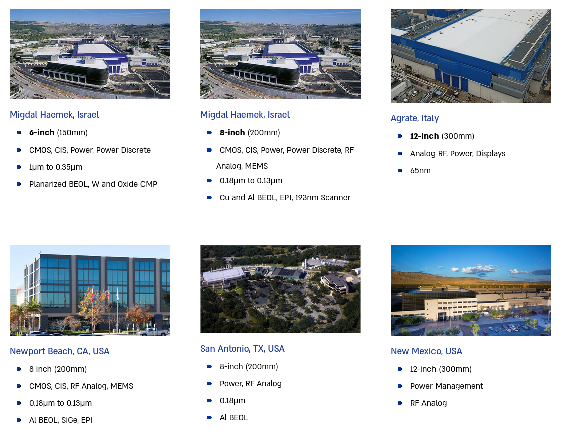

Is the Tower Semiconductor partnership dead? I thought they would do a UMC type of deal?
That wasn't a co-development situation like with UMC. That was just running as a second source capacity upside for Tower 65nm. Also, that was in Fab 11/11X in NM which never ran an intel logic technology past 32nm. Funnily enough, they even have it on their website as if it is their fab, which made me chuckle a little bit when I first saw it.
Didn't they shelve the fab they were building in Israel ?
The rumor was that they would finish F38 in IS, but 48 would get the shell closed up and then be left empty until they decided which process they wanted to run there. But there has still been no official word on that. If it was true you would think they would have specifically mentioned it when they announced the various capacity deferments they were making in Malaysia for 3D package test, Germany fabs, and Poland 2D assembly test?
