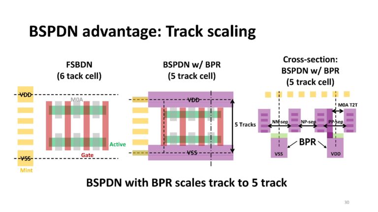

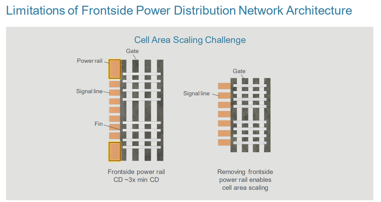

But when you look at things from the perspective of individual transistors is where the larger PPA upside is. As you said, SPR is technologically more advanced than PowerVIA gen 1. SPR won't intrude on the amount of space you have for wider nanosheets, the resistance should be lower, as should the parasitic capacitance. The major impediment native to A16's implementation is not being able to delete the power rails due to the need to support FSPDN and be backwards compatible with N2. Not making A16 BSPDN only provide a cell compaction for every transistor that is not dependent on the exact chip and how routing limited the design is. There is nothing wrong with TSMC doing it this way, and for their business it is almost assuredly the best way to go about things. But it does hurt their area scaling and cost per FET. But you don't need to take IMEC or my words on the matter, let's look at some real examples to illustrate my point:
N5 short NAND cell: 210nm with a 28nm M0 pitch and 7.5 M0 tracks
N3 short NAND cell: 162nm with a 23nm M0 pitch and 7 M0 tracks (2 1.5x M0 tracks for power)
i3 short NAND cell: 210nm with a 30nm M0 pitch and 7 M0 tracks (2 1.5x M0 tracks for power)
i4+20A BEOL cell: 210nm with a 36nm M0 pitch and 5.8 M0 tracks

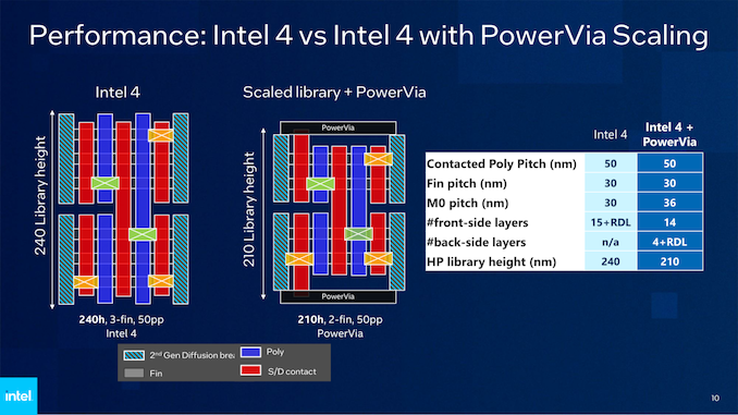

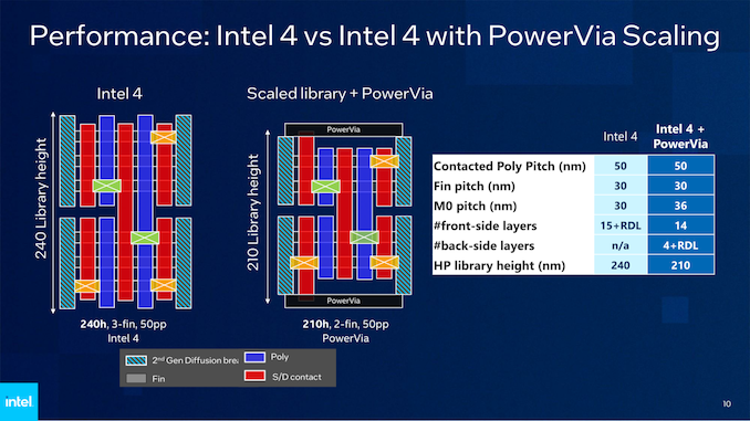

On i4+powerVIA intel can hit the same cell heights as N5's HD cells even after walking back M0 pitch from the intel 4 30nm to an intel 7 like 36nm. When you compare to N5, N5 needed a 22.2% feature shrink (not far from the 30% needed for a 2x lithographic shrink) to have the same cell height as intel 4 + power via. Allowing for 2D direct print EUV instead of 1D EUV-assisted quad patterning. Intel claims the cost saving was great enough to make the BSP process cost neutral. Put another way, when you use BSP like this you can reset your BEOL lithographic requirements by a full lithographic node of scaling. But you don't need to use it that way either. If you wanted, you could also keep M0 pitch the same and get to smaller cell heights. With the same 5.8 tracks and 30p you could have 174nm height, and with 23p you could do 133nm. Given the slowing of pitch scaling and the cost associated with doing so, I can't overstate how large of a boon this is for the AC part of PPAC. IMEC, intel, and cadence both claim that a BSP only process will shrink cell heights by 20% and AMAT claims a 20-30% cell height reduction. Note: this is NOT the 10% or so utilization increase reported by TSMC and intel for A16/i4+powerVIA. That "up to 10% utilization improvement" is extra gravy on top of the flat 20% area reduction from removing the power rails from the cell (or you can of course can also be used to relax metal pitches and reset metal pitch scaling by a full lithographic node of scaling).

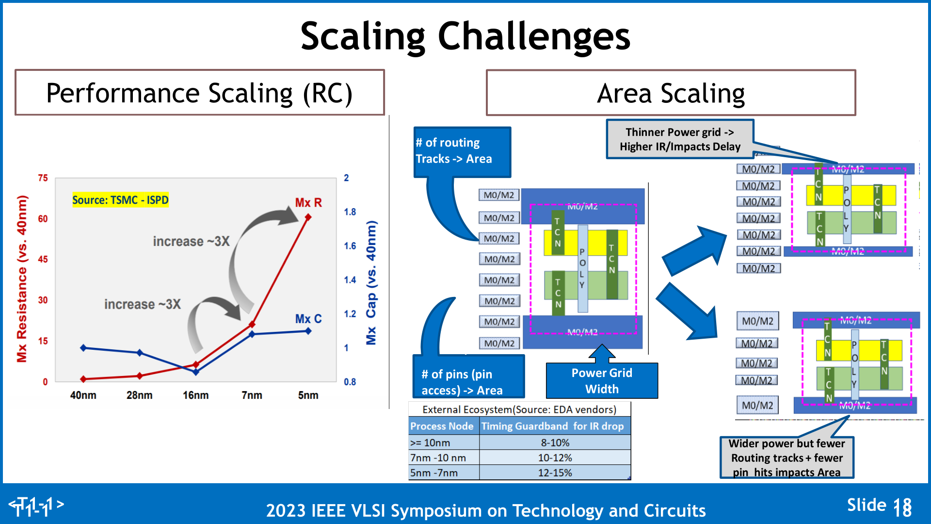

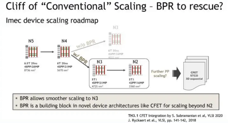

Supporting diagrams and illustrations below courtesy of Cadence, IMEC, and AMAT:
Yeah, I can add some color to my statement. TSMC said SPR is optional on A16 and that N2 IPs are drop in compatible. This indicates that A16 uses standard cells with the same size as N2, and that the M0/M2 power rails are still there (hence preventing any compaction of the cell height). It is for this reason why I call it a partial implementation as opposed to 18A which is BSPDN only and so it gets all the benefits rather than just a good chunk of them. My observation that A16 doesn't have shrunken cells from N2 is further backed up by their statement of 7-10% density boost, which is exactly inline with intel's findings of a 10% utilization uplift for a Crestmont E core. Of course, as you indicated, the exact benefit will depend on your power grid. A hypothetical chip with practically no PDN would obviously get little to no benefit.

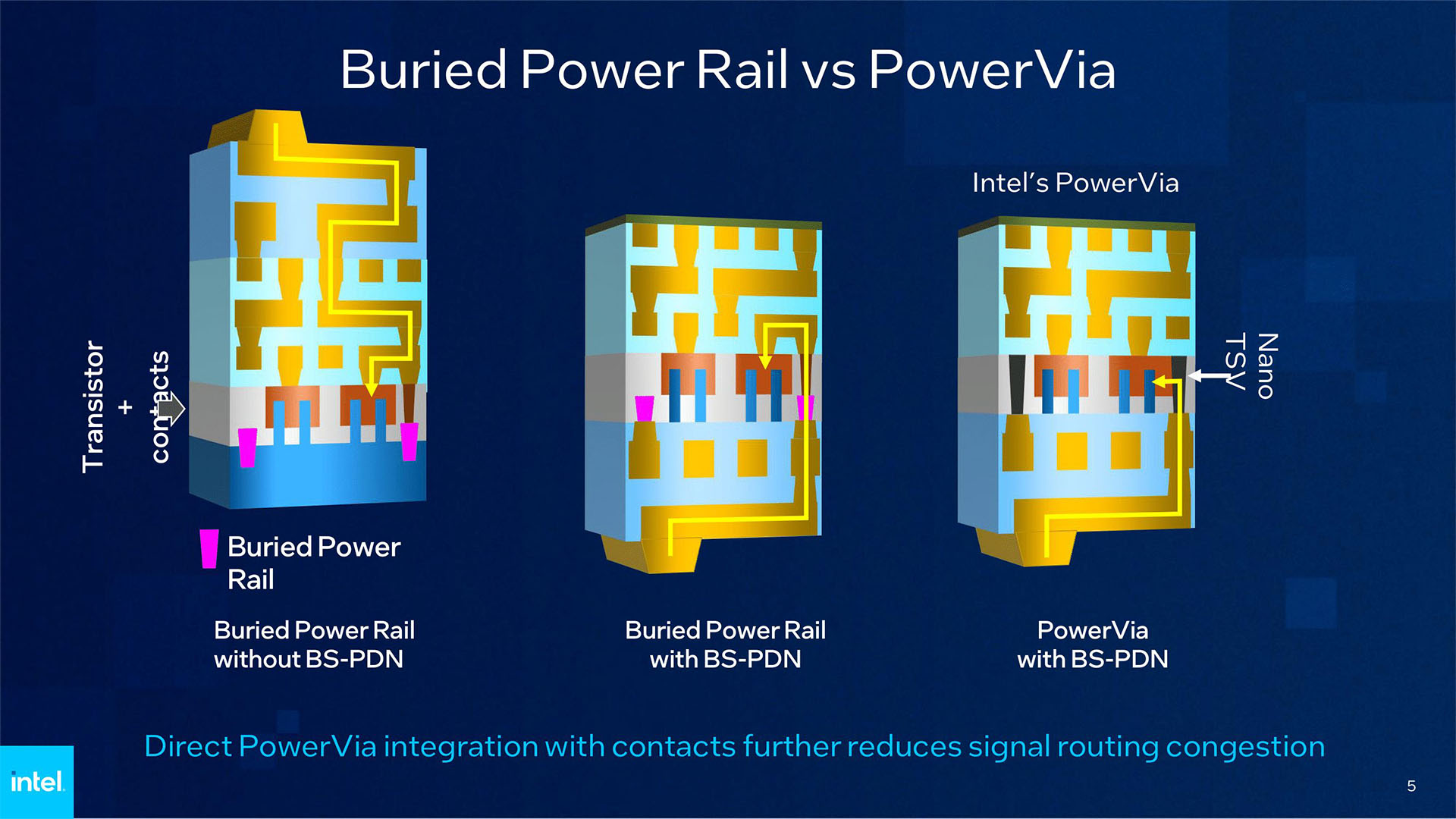

So the diagrams intel has shown show the powervia coming up inside the cell boundary region and then the TCNs extending over the top of the boundary region to land on the powerVIA. Since this is below the metal routing layers it does not minimize the benefits I had mentioned about deleting the power rails. However, as you can see from the image what does happen is the nano-TSV reduces the space available for the nanosheets. So all else being equal the nanosheets for a nano-TSV or BPR type of BSPDN cannot be as wide as a BS-TCN/direct epi contact from the BS type of BSPDN process. As I previously mentioned that nano-TSV is a big chunk of extra capacitance, and that a BS-TCN will be shorter/have lower contact resistance than a BPR or nano-TSV scheme. For these reasons it is not shocking that intel was showing off TEMs and E-test data of powerVIA gen 2 BS-TCNs and also BS-GCTs at last year's IEDM both on a regular GAA process and to demonstrate functional CFET inverters. Direct backside contacts are the ultimate end state for BSPDNs and backside signaling. With that said once we are talking CFET the top device will need a BPR/nano-TSV like structure to get their backside connectivity.

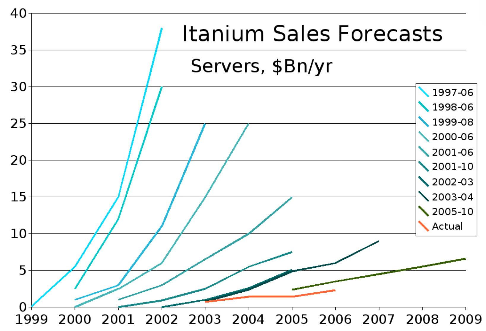

Many of these chips were made at a factory where I worked. A lot of Intel employees even referred to it as "ITANIC"... HP and Intel combined on this winner of product line.
HP did the digital design on the CPU. Intel designed the chipset, which was a multi-CPU-socket design. Intel fabricated both, of course. The whole idea was to get HP off PA-RISC, and letting them design the CPU was apparently the bait. I was involved with the first generation chipset. The Itanium name, derived from the conjunction IT-anium, was coined by Craig Barrett's wife, Barbara. (She was a former US ambassador to Finland, and the Secretary of the US Air Force. A very impressive person.) Unfortunately, Itanium was a derivation of VLIW CPU architecture (called EPIC), which can be useful for special purpose processors (Intel's Gaudi AI chip is said to use VLIW), but for the general purpose case, superscalar architecture is a better parallelism strategy due to the complexity of the VLIW compilation problem. An incredible waste of money and many engineers.

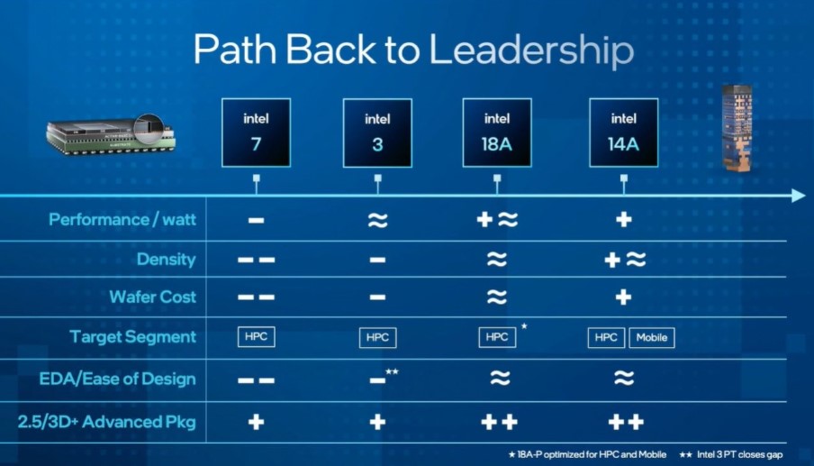

According to Intel's slide, the cost of 18A is on par with tsmc :sneaky:
Intel's mouth straight to God's ear :)
I fail to see how Intel's cost per wafer (fully loaded) on 18A can possibly be less than TSMC's cost on N2 for the following reasons:
1) N2 does not have BSPD and likely takes fewer passes than 18A
2) N2 cost will be spread over a ton of chips from many companies while 18A will be for Intel only in 2025 (for the most part) and will be used by others slowly in the following years .... all while Intel continues to pay for the equipment AND bring their new NXE 5000 series EUV scanners on line for 16A.
I think that Intel is making a mistake messing around with the numbers so their processor divisions look decent and the foundry looks very bad. You can't "hide the weeny" forever :).

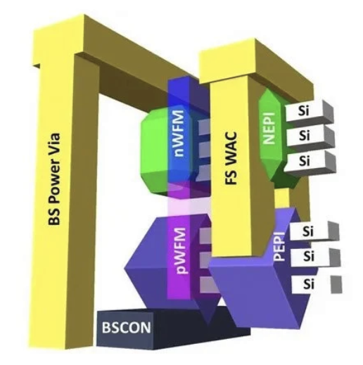

Intel 18A has two sets of interconnects (backside and frontside) which have to be separately aligned and patterned. TSMC A16 would be the same.
Maybe I didn't understand what you meant, but wasn't that always a given regardless of implementation? Similar to making the statement that a transistor's contacts need to be aligned to the transistor and not shorting to the wrong terminal or the wrong transistor.

I thought that with A16 the TSVs came up directly underneath the transistors (bottom-side contact) instead of up into a "NanoTSV" and then sideways into the transistor like Intel?
Same alignment problem (top-side vs. backside) but in theory more efficient/advanced -- though this advantage (more than?) disappears if TSMC then use the same libraries with power rails as N2...
