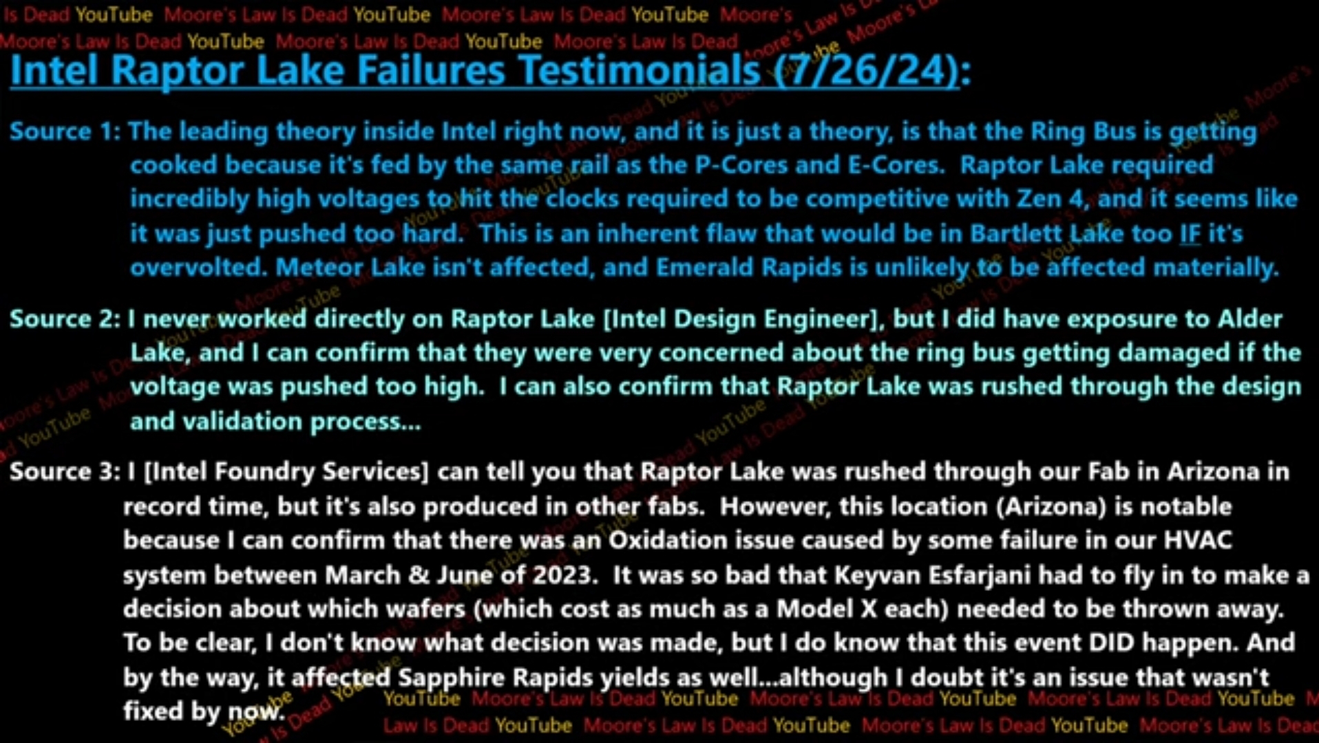

Credits to the YouTube channel Moore's Law is Dead.
I watched the video and when it got to this slide I had to pause for a minute because I was laughing. originally I thought, maybe there is a 10-20% chances he has actual sources but they go way over his head, but now I am pretty confident he just makes stuff up or scrapes leaks from elsewhere on the internet. The best part for me is the escalating levels of absurdity, it is so good :ROFLMAO:.
Point 1: EMR doesn't have a ring bus so it by definition can't get get cooked. Also the cores run well under 1.5V, heck well under 1V even when single core boosting. It is also funny seeing him slyly backpedal from Bartlett lake is a client part to it was never a client part after folks said he was dumb and it was an NEX part online. If the problem was the RPL/ADL ringbus if anything that problem should replicate in MTL since intel claims MTL CPU is a slightly tweaked version of RPL.
Point 2: Hard to imagine that a 10 year stress test wouldn't unearth the ringbus "cooking itself" at 1.5V.
Point 3: I don't see how running priority material through the fab is part of the problem. The HVAC going out is really funny to me. The tools have their own environments separate from the fab and for many steps of the process are in a vacuum (like PE-xVD, Etch, etc). Wafers are exposed to much hotter temps during wafer processing than Arizona springs can ever do. BOEs like the RCA clean are specifically in the flow to remove oxides. When in storage wafers sit in N2 precisely to prevent oxide films from growing. Then we get even more comical with claiming Keyvan had to fly to Arizona and sort through every wafer. If we run with this story what would Keyvan know about which wafers can be saved or not? That would be something only defmet and e-test folks would do and know. The image of Keyvan sitting on the floor looking at each wafer in a clamshell with a mountain of wafers behind him does put a grin on my face. Where I completely lost it was an intel 7 wafer costing as much as a Model X :ROFLMAO:. I'm snickering just typing that an intel 7 wafer costs 3-4x what TSMC might be selling N2 wafers for in a couple of years. Then we end on the last point "I don't know if the HVAC system that keeps the me cool and is causing oxidation is fixed yet, but it probably is". Just *chief's kiss* it is all wonderful.
On a less jolly note:
Given how Intel has handled (screwed over their own enthusiast customer base) this issue, I'm not planning on ever purchasing another Intel CPU again.
This is absolutely one of the worst ways Intel could respond to this absolute mess they dug themselves into. Instead of apologizing and trying to make things right, they pretend it's not a issue, stall, act like it's not a big deal and now try to sweep things under the rug while doing absolutely the bare minimum to make things right. 🤬😡😠
Agreed the way intel is handling this is terrible and they have opened themselves up for folks wearing tin foil hats to be more credible than themselves. I think intel needs to earn your trust if they want you or other DIYers' money back. Many folks in that circle seem to already "just buy AMD" and this has given a material reason for people to do this.
EMR chips are indeed fine. So your point 1, actually supports his claims.
Point 2. Stress tests are fine for sure, but it doesn't mean you can't have defective/marginal CPUs later. You just test a very early and small sample size when you qualify the process/device.
If you rush things as they did, the risk of missing/skipping few process corners is higher. The real concern here is the binning instead. If you lower the sort "bar" to get more i9 out of i7 chips (to increase your margins), you could put your shipped device under a bigger pressure than you thought/planned if it is somehow marginal. And so far, they definitely seem marginal.
Now, I didn't care about the given root cause of the excursion (although the environment could definitely play a role too, there is nothing to laugh at), but I was more interested at the Fab and the timeframe, since Intel didn't disclose this information yet. Now, we sure can't tell that that part is true, but it sounds believable at least. The other comment about the wafer cost is simply trivial. 5k, 10k or 15k per wafer, do you think it would matter when you have to decide if you have to scrap your material or not? It is a crazy amount of money for many months of Fab production. I bet at Intel nobody laughed 😅
The Intel response so far has been worrisome to say the least. Bad RMA management, no accountability, they tried to blame MoBo manufacturers, then the users, then they released a bios fix that it's not a real fix (it is just a performance nerf), now they promised a new fix, finally acknowledging the issue (their issue), but never stopped selling the unpatched CPUs anyway.
Perhaps you laugh, but at Intel, they definitely cry, absolutely.
If the thermal velocity boost is limited by the 100 C instead of the 90 C, because you wanted to beat your competitor at any given cost, the likelihood of something going wrong is now definitely higher. Process and equipments might be the same, devices are not though.
He said it was unlikely to be impacted materially. If he had any clue of what he was talking about he would know that a flaw with the ring bus is completely incompatible with EMR.
Every CPU gets burned in, not some small sample size. With how common the issues seems and the allegation that the problem is a design issue that impacts every RPL die, the probability of not seeing that is basically 0%.
Getting more i9s out of i7s would only matter if intel actually sold many of them. Desktop is like 20% of the CPU market and my bet is that of that 20% less than 10% are i9s. If the problem was binning too many i7s as i9s, why does the desktop i7 also seem to have so many problems.
It is a laughing matter when the information in the video is clearly made up. I explained why that quote 3 is absurd, if you don't want think critically about that information that is your prerogative. Personally I think I would notice the temperature in my fab being like 20 deg F hotter than normal. So if you want to believe that a totally real "source" couldn't even tell you if the HVAC system is working again (over a year after the alleged outage) that is your lose not mine. He could have made up literally any other cause for oxidation and it would be far more believable than what he rolled with.
I know one who is laughing right now. To ground your understanding anyone who says an N5 wafer is priced near 20k has actually no clue what they are talking about or any inside information since the actual price is closer to half of that. For his "source" to claim an intel 7 wafer costs 70k proves without a shadow of doubt that there is no source. As I stated the comments got even more absurd and detached from reality as he went on.
The 13th/14th gen issue is real and you are right it isn't a laughing matter. However this ad-lib of a video is nothing but a laughing matter. When the theory has so many logical holes and has information that obviously false I have no reason to take anything in that video seriously.
What Intel 7 70K per wafer 🤣 it is more at between N6-N4 Price iirc this guy sometimes makes unbelievable stories
