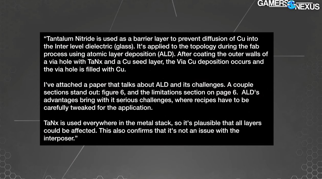

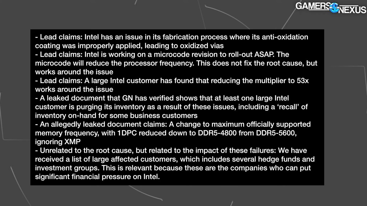

Apparently GamerNexus investigation and sources shows this info regarding stability

Official Intel Statement: (note they touch on the oxidation theory below)
As per Intel PR Comms:
Based on extensive analysis of Intel Core 13th/14th Gen desktop processors returned to us due to instability issues, we have determined that elevated operating voltage is causing instability issues in some 13th/14th Gen desktop processors. Our analysis of returned processors confirms that the elevated operating voltage is stemming from a microcode algorithm resulting in incorrect voltage requests to the processor.
Intel is delivering a microcode patch which addresses the root cause of exposure to elevated voltages. We are continuing validation to ensure that scenarios of instability reported to Intel regarding its Core 13th/14th Gen desktop processors are addressed. Intel is currently targeting mid-August for patch release to partners following full validation.
Intel is committed to making this right with our customers, and we continue asking any customers currently experiencing instability issues on their Intel Core 13th/14th Gen desktop processors reach out to Intel Customer Support for further assistance.

Opinion from MLID: Intel is just trying to buy time by lowering the voltage because there is no enough CPU for RMA.

For the purposes of semiwiki I think this is the most interesting nugget. Excursions happen to everyone and what separates the men from the boys is when it is found. Considering all the testing/burn-in that these sorts of products go through it is hard to imagine that many defective chips could get past without intel knowing about it. So there are two question marks for me. One is why did these chips get sent out knowing about this or recalling the allegedly small run of impacted dies? Maybe the issue was found to not be something that would be a reasonable issue and the microcode causing the chips to request more voltage than they needed made it an issue? The other question mark is what will intel do to ensure external customers that this won't happen on their products. If it was an intentional call to release these CPUs, then IF needs to demonstrate that enough inline metro is in place for any issues to be detected in-line before it gets to customer sort, and that foundry wafers will be scrapped if there are any issues. It is good business for an IDM wants to salvage every good die they can. However a foundry customer will demand that their dollars don't buy at risk material. If this oxidation excursion was an accidental slip that is a far bigger issue that would really have me squirming if I was a customer. If this was something that slipped past all of intel's quality nets, intel needs to drop everything and give current and potential customers a roadmap with milestones on how they will rebuild their quality culture from the top up (assuming said customers haven't already asked which if we are being honest they probably would have if this was a failure of IF's quality systems).
