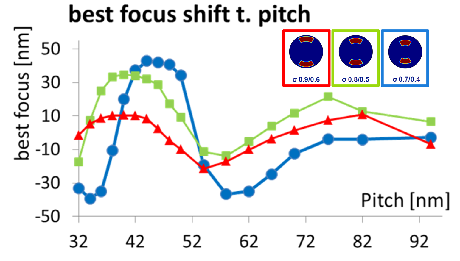

Even with ~50 nm pitch, stochastic behavior is still significant (https://www.semanticscholar.org/pap...bert/4773b3807b16e62a1fdb5aba1057b2989136f210), so the yield or throughput would still be impacted. A single exposure illumination also limits the pitch due to shift vs. focus, as well as best focus vs. pitch (http://euvlsymposium.lbl.gov/pdf/2015/Oral_Monday/Session2_EUV Insertion in Manufacturing 2/S2.4_Wittebrood.pdf).

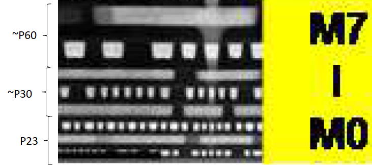

I visually estimated the lower metal pitches from Figure 15 of the N3E IEDM paper 27.5:

The 23 nm pitch layers cannot be single exposure since the pupil fill is too low, which means the EUV system itself is absorbing a lot of the EUV light. There is also cross slit rotation more severely affecting the dipole illumination.

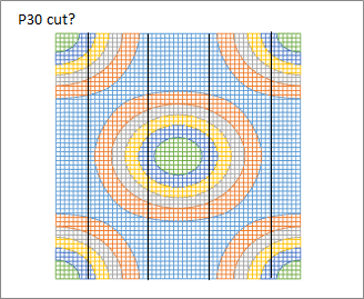

The next few layers I estimated to be around 30 nm pitch. Presumably these would be assumed to be the single exposure layers (edit: should still be double-patterned), but the M3 line gap space is also tight (~30 nm), so a cut is still necessary. It seems cuts are not included in the single exposure description, but the layer should be considered a multi-patterned layer nonetheless, since a cut is an additional exposure. And as far as safe cuts are concerned, SALELE would still be the preferred way.

M5 looks like it may not require cuts since the gaps are wider. Above M5, the pitch jumps up ~2X, so it looks like around 60 nm, very relaxed, like early double patterning days.

The 23 nm pitch layers cannot be single exposure since the pupil fill is too low, which means the EUV system itself is absorbing a lot of the EUV light. The next few layers I estimated to be around 30 nm pitch. Presumably these would be assumed to be the single exposure layers, but the M3 line gap space is also tight (~30 nm), so a cut is still necessary. It seems cuts are not included in the single exposure description, but the layer should be considered a multi-patterned layer nonetheless, since a cut is an additional exposure. And as far as safe cuts are concerned, SALELE would still be the preferred way. M5 looks like it may not require cuts since the gaps are wider. Above M5, the pitch jumps up ~2X, so it looks like around 60 nm, very relaxed, like early double patterning days.
I’m not even going to attempt to figure out how you derived all of that information from one low resolution cross section.

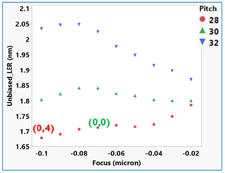

Recent data https://www.researchgate.net/public...ty_electrical_test_and_voltage_contrast_study shows 28 nm pitch having an 80 nm difference of best focus (for minimal LER) from 32 nm pitch:
The illumination was targeted for 28 nm pitch.
What phenomenon causes LER to improve when focus is off by -70nm? You can see the LER decreases even further at -100nm but Fig. 4(b) shows many other defects by that point (they do not show the images for less than 60 which would have been interesting).
It appears to be a LAM formulation 3-layer dry resist, in which case the resist is only about 20 to 30nm thick, so depth of focus interior to the resist does not seem the reason.
