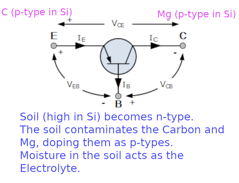

Here's the theory:
We have Carbon, which is a Group IV element, so in silicon that would make it a p-type material, heavily doped because it fouls in soil. Then we have the Mg which is a Group II element in silicon which is also a p-type element and is doped by the oxidation process (the other heavy metals in the surrounding clay embed themselves into the Mg as it corrodes, I've witnessed this.
Now we have a PNP transistor with the Emitter being the Carbon, the Base being the Soil and the Collector being the Mg. Also, because the soil is moist, creating an electrolyte, it allows electrons to flow.

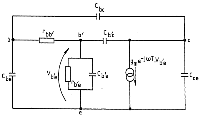

And that made me think of the Pi model for a transistor:
And I'm still trying to develop an Ltspice model that will work, but this is what I have for now:

One thing I would say -- and it might help is:
If you take a PNP transistor, and measure the open circuit voltage (with a voltmeter) between any and every contact you will see: 0V. (same as with a PN-junction diode)
If you connect the terminals of a PNP transistor together -- either shorted or through resistors -- you will see zero current flow. 0 uA
Your earth-battery arrangement/ prototype does not look like a PNP transistor.
Keep going though!
I'd focus on the battery aspect. A battery, and diode or transistor are very different.

Hi Rob
In reference to the above:
"I imagine you don't normally want a transistor to have its own voltage potential compared to ground, which is why the materials are called "semi"-conductors."
This is incorrect.
"We have Carbon, which is a Group IV element, so in silicon that would make it a p-type material"
This is incorrect. Carbon doped Silicon is an intrinsic semiconductor -- neither n nor p-type.
"... but I can't seem to find the electric potential of SiGe (Silicon Germanium used in most p-junctions) except that it is a semiconductor."
This doesn't make sense, to be honest. SiGe is a semiconductor alloy, and it's used in a number of applications. The electric potential of a SiGe region/material lump could be anything, depending on the circumstances. i.e. what it's connected too. You also need to be careful of the subtleties of electric potential vs the electro-chemical potential (fermi level) in semiconductor devices.
Proper Mg doped silicon would be a double donor (I think). So, it'd be n-type. It's not a common thing to do, however.
This is not an attack on your work: subjects like semiconductor and solid state physics aren't straight forward. They need a significant amount of study. Simply speculating, guessing, or theorizing how semiconductor devices work will mislead you.
IMO: you cannot make a transistor in the way you suggest.
Good luck with your work.

Thank you so much!
I took none of that as an attack, but a boost to my knowledge. I have little knowledge of semiconductors, which is why I'm reaching out to the community that does. Lots of great points here.
Never heard of an intrinsic semiconductor before and did a bit of extra reading already. Thank you for that. And for pointing out the difference between fermi level and electric potential. I had noticed that in other posts, but without explanation. You didn't explain the difference either, but you at least showed where the difference lies which helps me understand better.
What this has done, is helped to dissuade me from the transistor theory and put more effort into the earth battery cell characterization. In that, I consider your answer to be complete and the subject closed. However, if you felt like expanding my knowledge in some of those points above or pointing me to some good reads, I would be grateful. I love knowledge and inventing.
