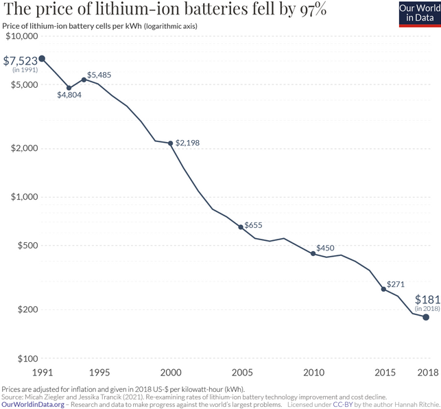

And pack-level Li ion prices have now dropped to almost half what the cell-level prices were in 2018 on your graph.

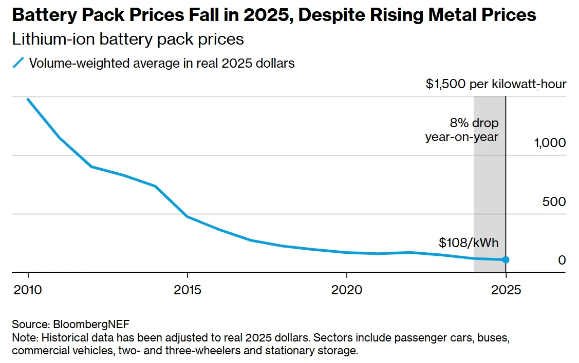

Yep, I only used that graph because it showed prices for the past few decades, but actual pack figures are even lower than your chart for utility scale ESS applications since it includes vehicles. And keep in mind a lot of projects in the US still use NCM chemistry, utility scale LFP ESS in China right now average $60/kwh, all costs inclusive for whole system. Kind of like solar, the battery cells themselves have become cheaper than the rest of the ESS, solar modules are $0.07/w for a container, FOB China for any tier 1 supplier, good quality inverters cost more than that per watt, even mounting rails, wiring/conduit cost more than that per watt, they're no longer the priciest component in the system. With batteries, I'm getting tier 1 suppliers quoting around $30/kwh for even modest quantities, the rest of the BOM (i.e. housing assembly, busbars/wires, BMS, etc.) cost more than the raw cells.
CATL announced $19/kwh for their sodium ion cells, they're worse than LFP in almost every metric now with the exception of cold weather performance, but if they're quoting that now and I'm hearing projections of $10/kwh by the end of the decade...that means $30/kwh all inclusive utility scale ESS not too far away at which point, even $10/w nuclear power plants can't compete in all but the smallest geographies. And frankly, I'm not much of a proponent of hydrogen, but once you have solar get so cheap, you can brute force your way through conversion inefficiency for hydrogen or other liquid fuels (ethanol, methanol, ammonia, synthetic gas/diesel) a la Fischer-Tropsch, Sabatier or Haber processes. Batteries storage full and tons of solar idling? Just use that excess capacity to produce fuel. We're not going to have intercontinental airliners or container ships powered by batteries in our lifetime, but that could be a viable path to decarbonizing those sectors. There's 1.5TW of solar module production capacity as of this year in China alone. US uses about 500GW of electricity 24/7. US capacity factor for solar ranges from 13.5% in December to 31% in July. 4TW of solar would provide all the electricity used in this country to cover the shortest months. That's under $300b in module costs and just over 2.5 years of China's module production capacity. It's no longer a rounding error and that's saying a lot from a guy who at one point worked in oil & gas!
