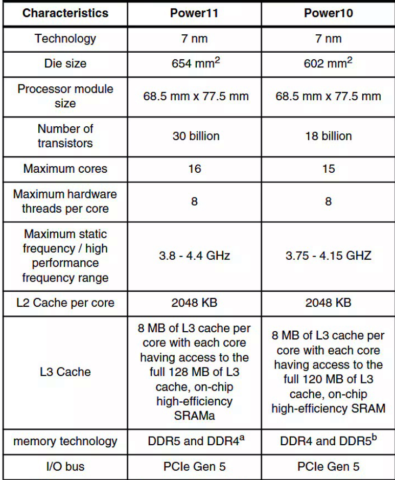

I saw this post on X, and was curious how Power11 is achieving such a significant increase in density over Power 10, with both (in theory) being on the same Samsung 7nm node? Clock speeds are actually up a bit, so I'm thinking this isn't a HD vs HP library situation..
Power11: 45,9 MTr/mm²
Power10: 29,9 MTr/mm²
Power9: 11,5 MTr/mm²
Source:
It's still less dense than average(not theoretical maximum) Intel 7(former 10ESF) based CPUs, so It's kinda doable.
It looks like they weren't maxing out the transistor density to begin with.
According to Scotten Jones' analysis back in 2018 about Samsung 7nm node:
"The calculated transistor density is 101.23 MTx/mm[SUP]2[/SUP] based on what we know today although there is some uncertainty in M2P and track height in that calculation that will hopefully be cleared up in the full paper. The calculated density improvement versus 10nm is 1.86.
101.23 MTx/mm[SUP]2[/SUP] is slightly less than our calculated value for Intel’s 10nm process and slightly more than our calculated density for GLOBALFOUNDRIES and TSMC’s 7nm processes."

I think while the Samsung comparison is accurate (and a great reference point), this might have been looking at the density of the 'old' Intel 10nm process before it was reworked to actually yield. I don't recall how much the density slipped though for what eventually became Intel 7. Ice Lake - the first actually yielding Intel 10nm product launched Sept 2019.
