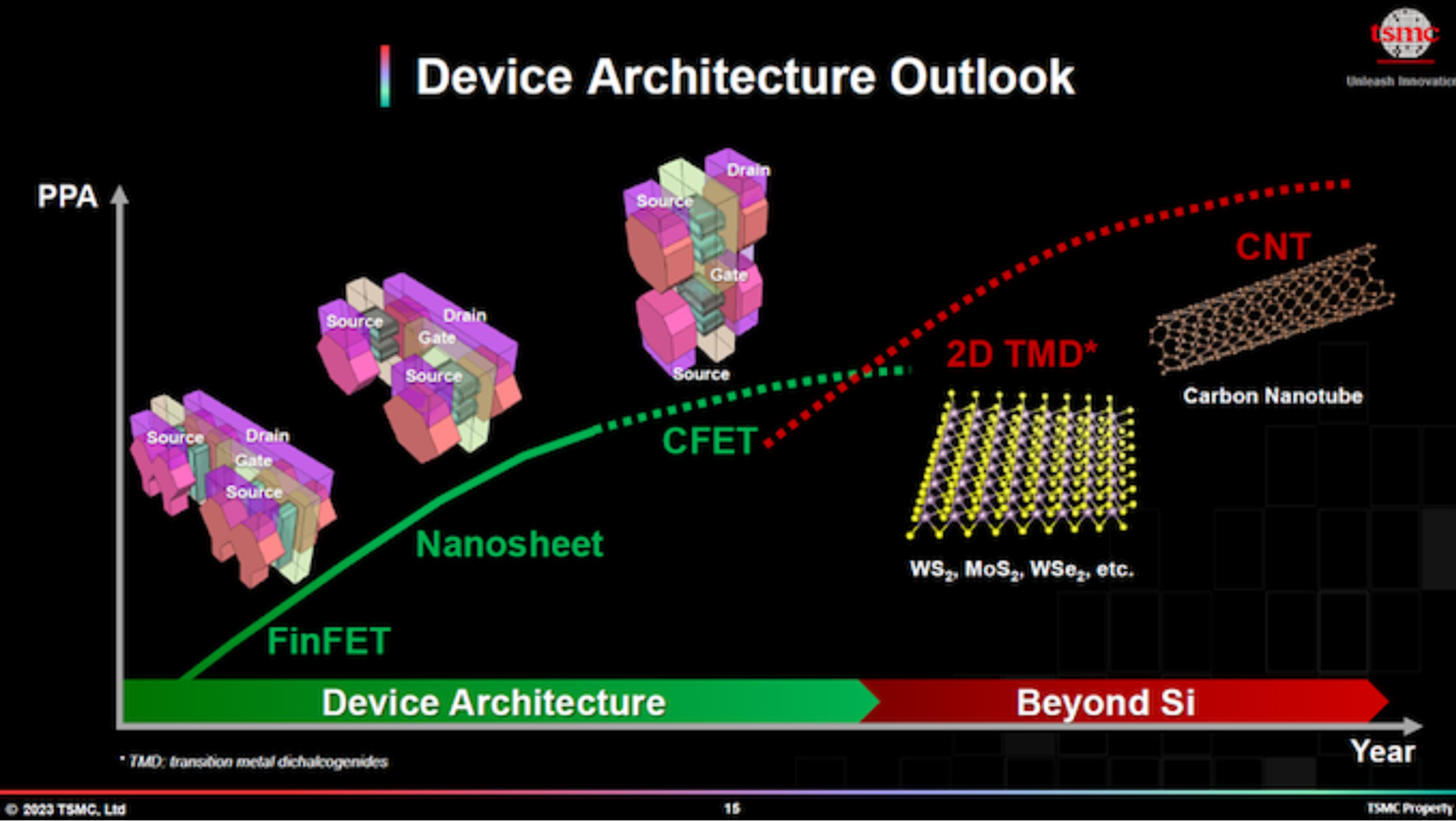

We are running 3nm now with 2nm (20A) due 2024 to 2026 depending on version and company. Samsung has talked about 1.4nm in 2027 based on a Horizontal Nanosheet with more sheets. My projections are 10A around 2029 based on a CFET, with 7A, 5A, and 3A CFETs to follow. Finally around 2037 we get CFETs with 2D and that is the 1,500MTx/mm2. All the pitches are achievable with High NA EUV.
Here is TSMC's device "outlook".
