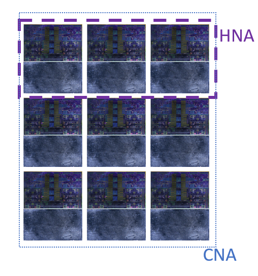

The 26mm x 33 mm field would be filled out with 3 x 3 Meteor Lake dies to maximize productivity, but the High-NA would only be able to scan a single row 1 x 3; it would need three of these to give 3 x 3. I only use Meteor Lake as a representative die size example.
Some inputs:
1. To become 3x1 field which means 3 scan steps not three reticles and no stitching required.
