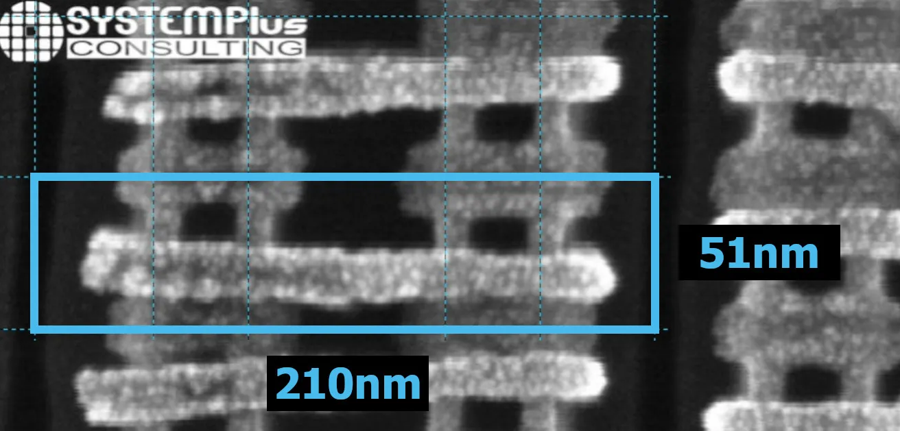

https://www.angstronomics.com/p/the-truth-of-tsmc-5nm
Great article. Thanks for pointing it out.
I have a working knowledge of GF and TSMC 12 and above, but know nothing on Intel and processes below 16-12nm. This gives me an idea of what to expect, but the poly pitch minimum isn't the most critical dimension within a geometry node IMO. Routability comparisons are probably more important than poly pitch. For example, we prefer a poly pitch of 96 vs 90 on TSMC 16, and a pitch of 84 vs 78 on GF. We create our own stdcells and P&R system. We don't pick minimum sizes. The decisions are based on routability more than absolute process minimums. Oh yea, make sure you chip doesn't melt. Sometimes a little space is a good thing.
