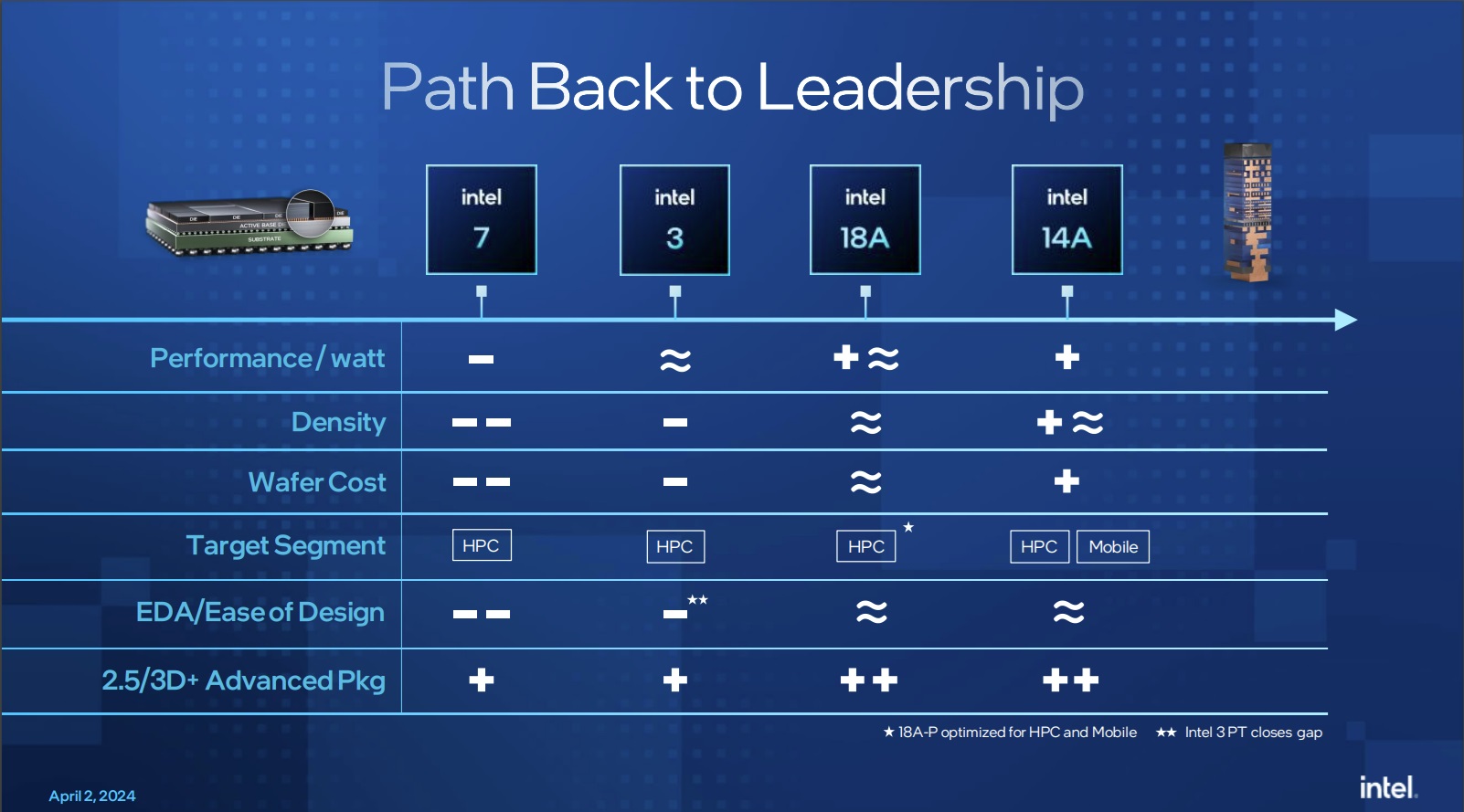

This is the most interesting slide. The dash means Intel is behind, the squiggles means Intel is comparable and plus means ahead. They don't say who the comparison is with but clearly it is TSMC. They key here is the Target Segment, so this is in terms of HPC. As far as performance goes I agree with this graphic but not performance per watt. I have a problem with wafer cost especially when yield is involved. I also do not agree with the 18A density comparison, if we are talking about TSMC. Samsung 2nm maybe, TSMC N2 no. EDA ease of use I can agree with since Intel is a big EDA customer but TSMC has the biggest EDA/IP ecosystem. Packaging is still a wait and see for me. Intel and Samsung are not doing packaging HVM for foundry customers as of yet in comparison to TSMC. On paper maybe but foundry HVM is a different deal altogether.
For 18A, the target segment is HPC (noteably ‘not mobile’). Is it possible that the density estimate vs competition is correct for that segment? High performance libraries for comparison instead of high density?

Where is the Intel 20A in this slide? Did Intel decide to kill/skip it?
With the introduction of 14A and its technical superiority, does that mean Intel push the year of gaining leadership position over TSMC further down to a future date?
Pat was talking about IFS which does not offer Intel 4 or 20A.

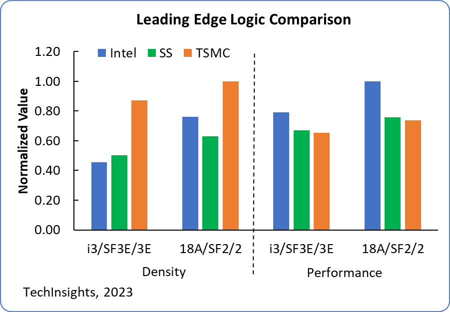

I have actual numbers for 18A pitches, I can't publish them but I can say that 18A high density cell transistors per mm2 are slightly higher than TSMC 5nm but lower than TSMC 3nm. To even catch up to TSMC 2nm, Intel 14A would need a big density jump and this is during a time when density jumps are getting harder.
According to an Angstronomics article (linked below) Intel 4 is denser than TSMC N5:
H280g57 gives a logic density of 92.3 MTr/mm² for 3-fin N5.... while Intel 4’s sole 3-fin library (H240g50) has a density of 122.8 MTr/mm².
So, if 18A is only slightly more dense that N5, then it must be less dense, or equally dense as Intel 4. Can this be true?
So, if 18A is slightly more dense that N5, then it must be less dense, or equally dense as Intel 4. Can this be true?
That is on a 3 fin to 3 fin logic cell basis. TSMC's N5 2 fin HD cell is 210h and is a bit denser than intel 4 HP library. I don't like the undercurrent of N5 being not as good as promised that permeates this article either. N5 was and still is a very compelling process. While TSMC was detail light with their pre-launch communications about N5, everything they said would be there is there.
but that's not fair - you can't compare a HD library with a HP library. It'd be interesting to compare N5 with Intel 3 HD library, but I assume those tech details are not know.

That is on a 3 fin to 3 fin logic cell basis. TSMC's N5 2 fin cell is 210h if memory serves and is a bit denser than intel 4 HP library.
