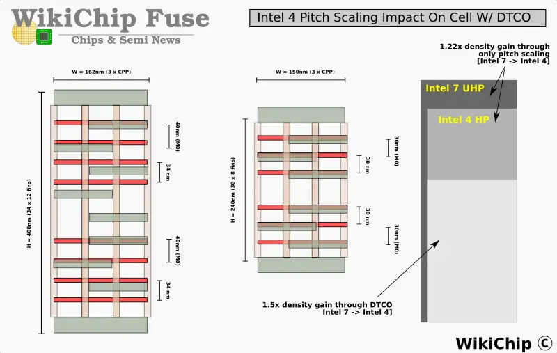

I love this image from wikichip for that very reason.
Tanj, what's "pitch gearing"?
The ratio of m0 and M1 to the underlying features. To a first order, simply tighter pitch is better, but there are also issues like how it connects. Intel 7 (fka 10) had 3 fins for every 2 M0 and also some constraints on where the M0 could contact the gate metal. Intel 4 allows M0 to contact on top of gate (ie. fin location) and the M0 pitch is same as fin pitch. I don't know what the M1 metal pitch was in 10. The Intel 4 orthogonal M1 and M3 (and M5) pitch is 50nm, same as CPP and I assume they are aligned over the gates.
This is not just more ways to connect, but more freedom how to connect to the gate. When I experimented manually with this layout it means a lot of basic cells need only M0, at XOR level you need a bit of M1, and it was not until I got to a full adder that I needed M2. M2 has a 45nm pitch - 2 M2 per 3 fins which is also a bit wonky since it is not a divisor of the 240 nm track height. This makes it a little odd in basic cell design since the available geometry repeats only every 6 tracks (45nm divides into 3 tracks, but then you have Vdd and Vss inverted, so 6 tracks brings you back to isomorphic). I'm surprised they don't just use 48nm.
When you go to BSPD you get back one M0 track that used to be used for either Vdd or Vss, depending on how you look at it, but also some M0 pathways that were blocked for keepouts where the power vias came down. So I expect Intel 3 with 2 fins per transistor and BSPD will be about as easy to route at the cell level as Intel 4 with 3 fins per transistor. Of course, Intel 3 will still be more crowded for routing between cells, but the lack of keepouts around tall power vias should help, too. And the freedom to add power connects nearly everywhere with immediate transition to bigger metal should reduce droop improving low voltage operating margins.

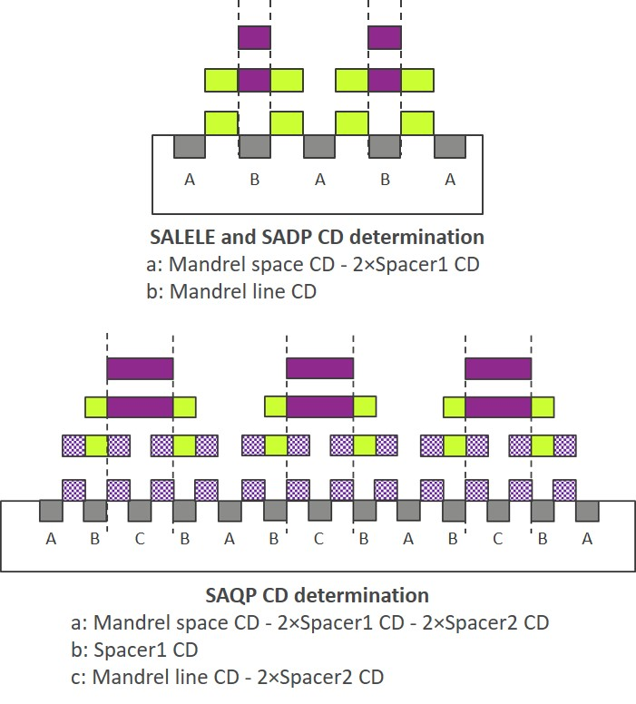

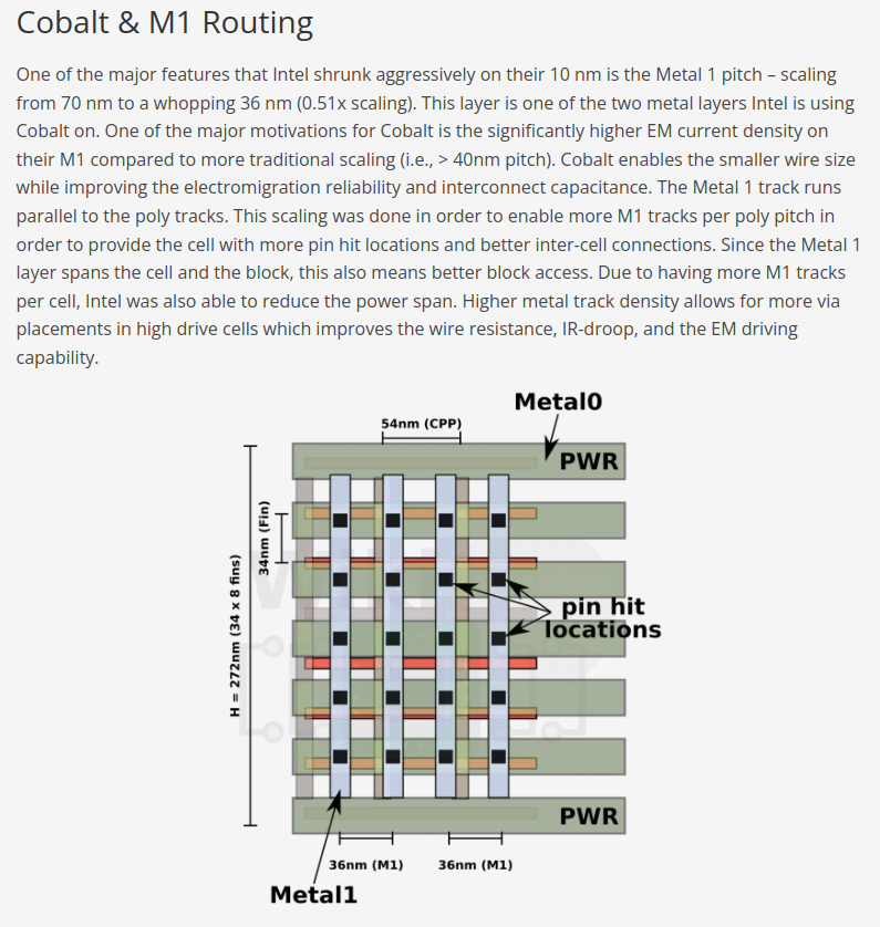

While looking for the explanation for why intel made the unusual choice of 36nm M1, I found one interesting nugget that I didn't know. That all 10nm std cells have a 7-track M0 arrangement. As the CH increased they would just increase metal pitch while keeping the arrangement the same. Seems really weird, but that might just be a byproduct of how pitch quartering works. IF SAPQ was the reason they did that arangment, I wonder why it is 7 tracks per cell and not 5 like the bellow example would indicate?

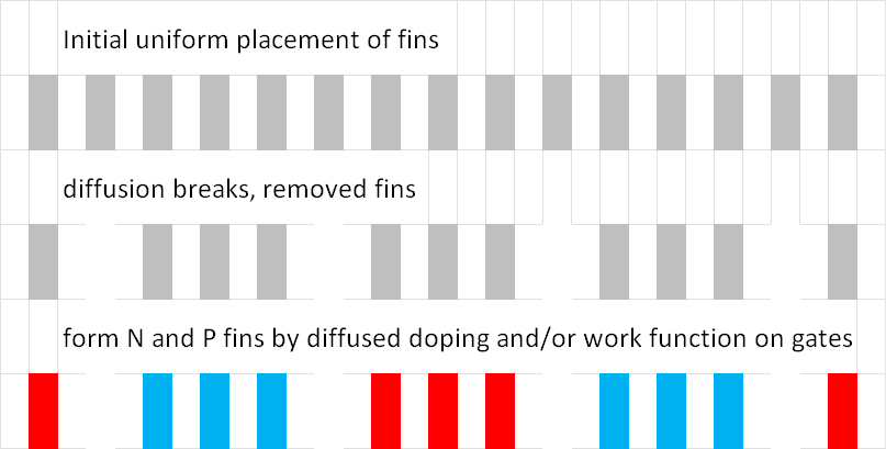

The A B A B A B A B .. pattern is endless, that makes the patterning extremely uniform and reliable. Deciding how to group them into tracks is quite separate.

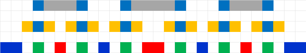

I expect the work flow is:
This allows the fins to be created as perfectly as possible since they are uniform in every order.
