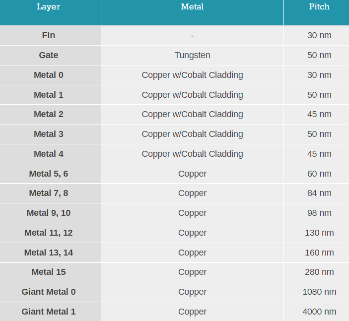

Can anybody provide the metal 5 and 6 pitch, and the via45, via56 pitch, and the via5 to metal5 pitch?
From the horse's mouth, intel 4 is:
I suppose another benefit to not shrinking metal pitches is not needing any new metallurgies (yet).
WOW. Nice stack! Thank you.
Via pitches weren't in the briefing, but out of curiosity why would they matter? Doesn't the metal pitch tell you all you would need to know as a designer?
Also courtesy of AnandTech's coverage of the intel 4 brief
You caught me! I was trying to calculate the pitch. It is vary complex. The via spacing and the via to metal spacing is probably the top 2 variables, but there are a lot more. You've got end of line rules, illegal zone rules, and many many others. It took us over a man year to finalize the GF and TSMC 16-12nm pitch, but a lot of that was because we create our own standard cells and place and route system. There are a ton of trade-offs. Even if you gave me the entire DRM, it would take me a month minimum to calculate the pitch. I was just curious. 28nm was so much easier.
We almost never go with minimum standard cell height on our own standard cells. Customers can use the foundry supplied cells, but they are typically so small that running P&R at 100% utilization is never done, or at least I have never heard of it.
