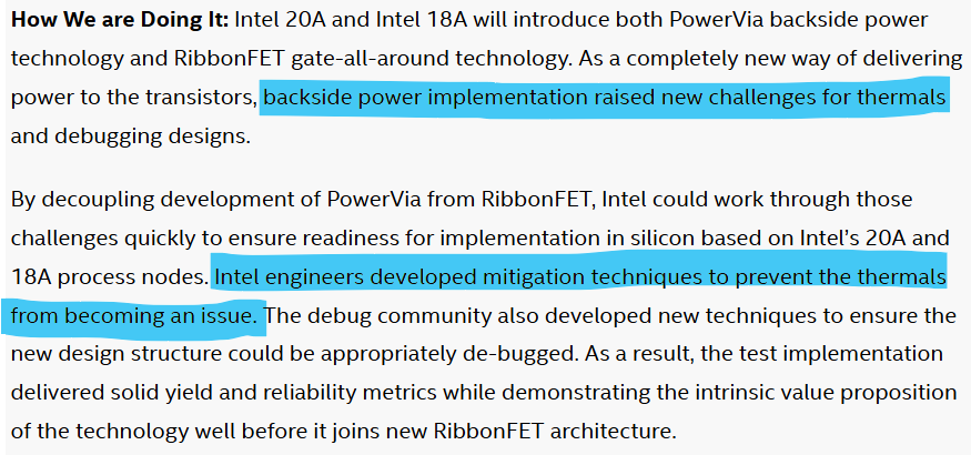

Pretty much word-for-word what I've been saying -- their detailed simulations predicted maximum on-chip temperature 23C hotter for BSPDN (1um to 3um square areas, Tj=80C instead of 57C -- but no details about heatsinking assumptions...) which is *very* close to the handwaving estimate of 20C for these sizes I gave earlier in the thread... :-)
All of which justifies TSMCs recommendation of BSPD for "HPC-class devices with dense power grids and active cooling", and shows the problem with using Intel 18A/14A for ASICs which don't fall into this category -- which is to say, most of them (by number of designs)... ;-)

Speaking as someone who has actually done thermal analysis comparison of FSPD vs. BSPD in real high-performance chips vs. high-school posting about copper thermal conductivity...
In a conventional FSPD chip the die is face down, the transistors are embedded in (or thermally directly connected to) a thick (typically 700um) silicon substrate, which has about half the thermal conductivity of copper. This conducts heat to the back of the die where the heatsink contacts it, as a consequence something like 90% or more of the heat leaves the chip this way. Even with this you get significant hotspots in regions with high power density, either at block level or all the way down to gate level, typically the hottest devices run maybe 20C hotter than the die backside -- the substrate also wicks heat away laterally (heat spreading) which helps keep temperatures down.
It's worth noting that the hotspot problem with BSPD is likely to get worse in future, because with every new process node the power density per mm2 tends to creep up -- and this will get even worse when stacked CMOS comes along, especially for the "bottom" transistor, which will also increase power density further. Should still be fine for HPC with nice cold liquid cooling (which will however get more challenging...), but even worse for everyone else without such a luxury... :-(
P.S. All the numbers above are examples for high-speed high-power-density circuits -- the actual temperature rises will be smaller for a lot of chips, but the difference will still be there... ;-)
P.P.S. TSMC will do a BSPD version of A14 about a year later, as a next-node follow-on to A16 for the same markets (e.g. HPC)
P.P.P.S. This is also the sensible order, FSPD first to MP to drive down the D0 curve, then BSPD for the reticle-sized HPC chips which really *need* super-low D0...
