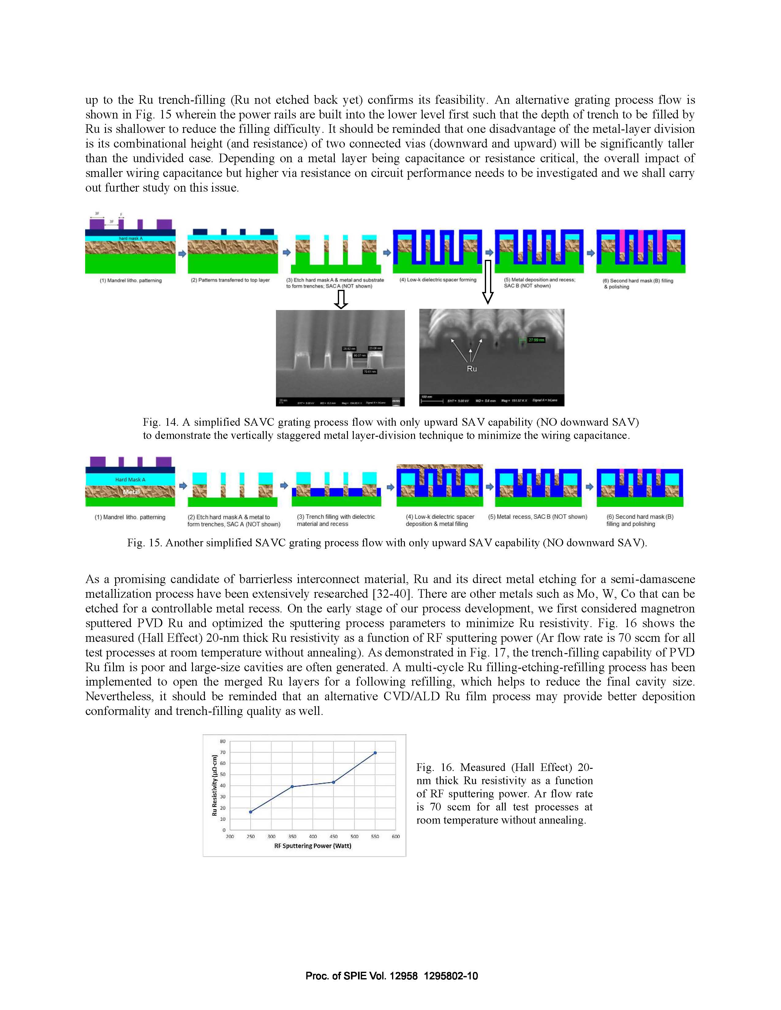

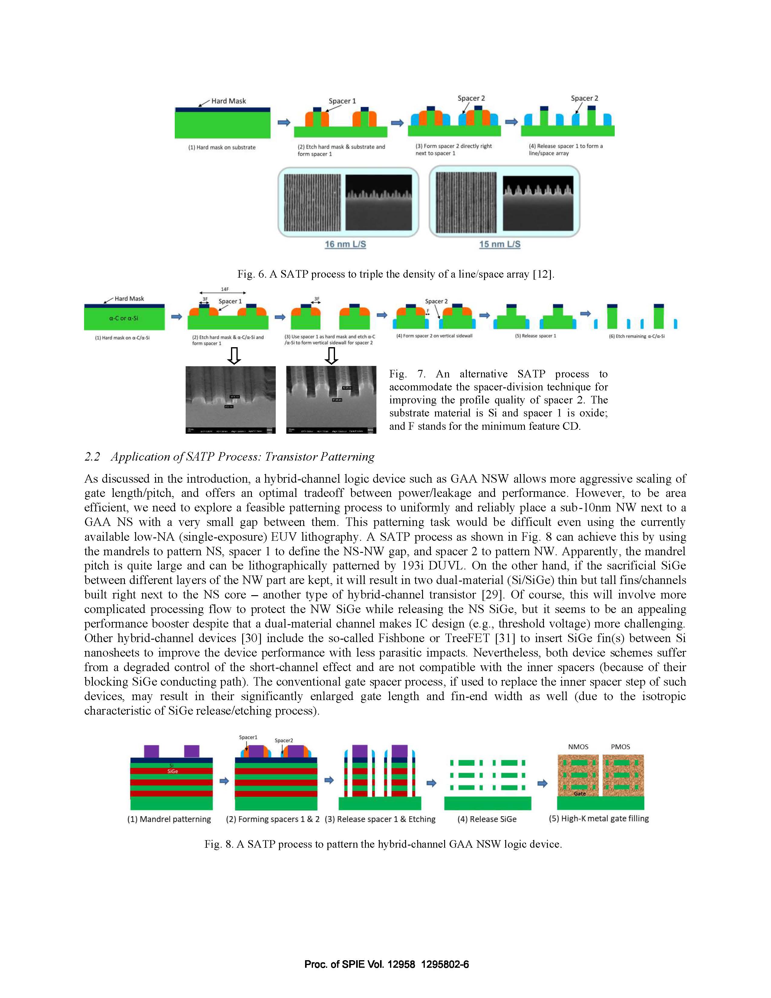

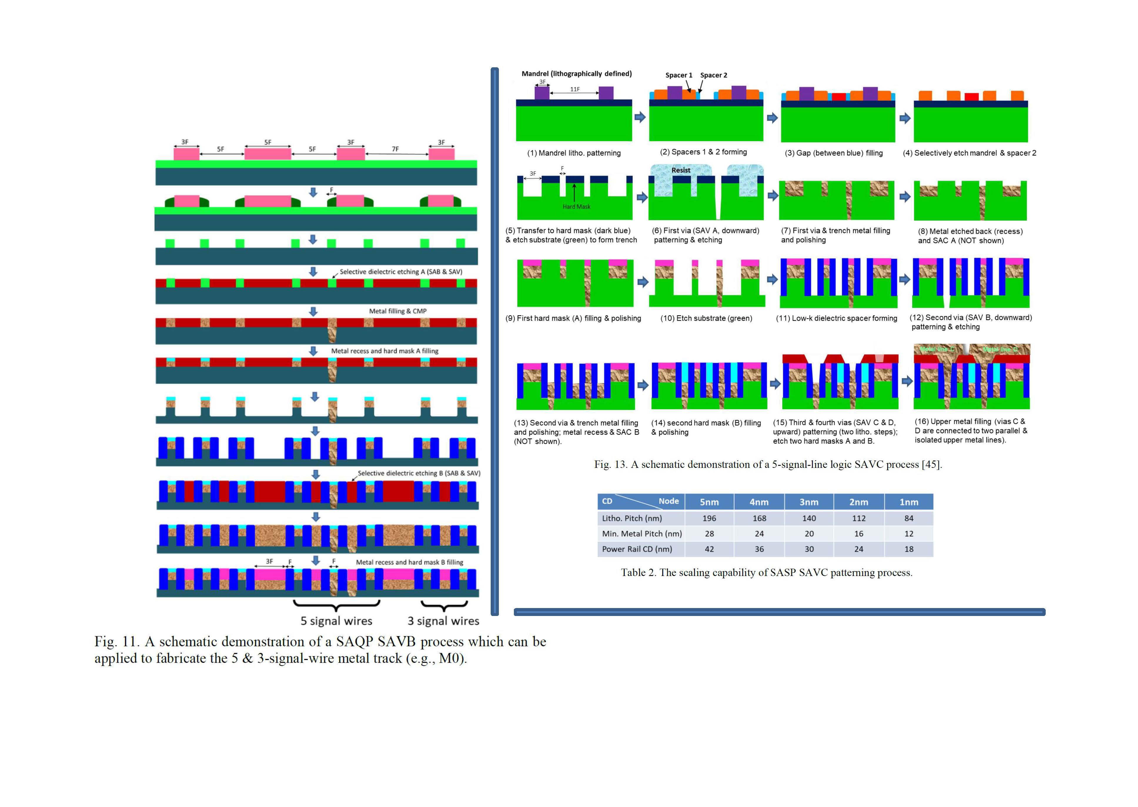

SPIE just published the papers from Advanced Lithography + Patterning. Here are a couple of pages, figures and table grasped from the 7x paper (see below) by Westlake University. Obviously, our industry should seriously think about if we really need high-NA EUVL. TSMC may again make a right decision (vs. Intel).
Paper: Mandrel/Spacer Engineering Based Patterning and Metallization Incorporating Metal Layer Division and Rigorously Self-Aligned Vias & Cuts (SAVC)

SPIE just published the papers from Advanced Lithography + Patterning. Here are a couple of figures and table grasped from the 7x paper by Westlake University. Obviously, our industry should seriously think about if we really need high-NA EUVL. TSMC may again make a right decision (vs. Intel).
If our industry could make chips with powerpoint the answer would be obvious, not EUV. Given the order book for high NA EUV, the real answer was made years ago to go down that road.
Of course it's not only ppt, they reported some preliminary experiment results to show its feasibility. High-NA EUV is not the only path. Several different approaches to scale down exist, including SADP EUV (low NA) patterning proposed by Imec. Intel booked some high-NA tools. I heard TSMC did not and Samsung might or might not. You are welcome to correct me if my information is incorrect.

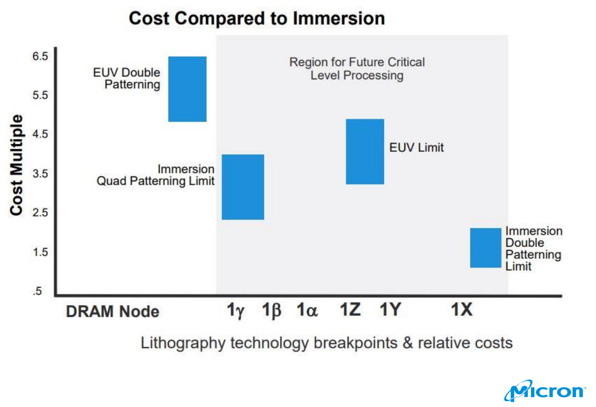

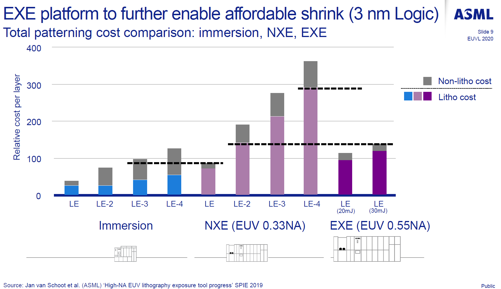

EUV had to be bought and subsequently used before the data was in, apparently. About the costs, some references below. Keep in mind, EUV resists are many times more expensive than DUV resists.

In the EUV-vs-DUV cost debate, we should also consider that EUV saves on cycle time. In the R&D phase, especially, it is important to get quick learning and to avoid long cycle times. One EUV layer may not make a big difference, but if a flow contains too many multiple exposures, the latter will add up and significantly slow down development. As long as there is some level of competition between foundries, faster development time will pay off. This must enter the cost equation when comparing litho solutions.
