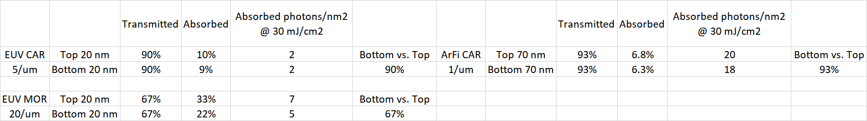

The resist is known to make a difference. A higher resist absorption coefficient makes the bottom half of the resist layer perform worse stochasically than the top half. The issue is far worse for EUV than DUV due to the thinner resist thickness used by EUV:
Also discussed in this article: https://www.linkedin.com/pulse/euv-resist-absorption-impact-stochastic-defects-frederick-chen
